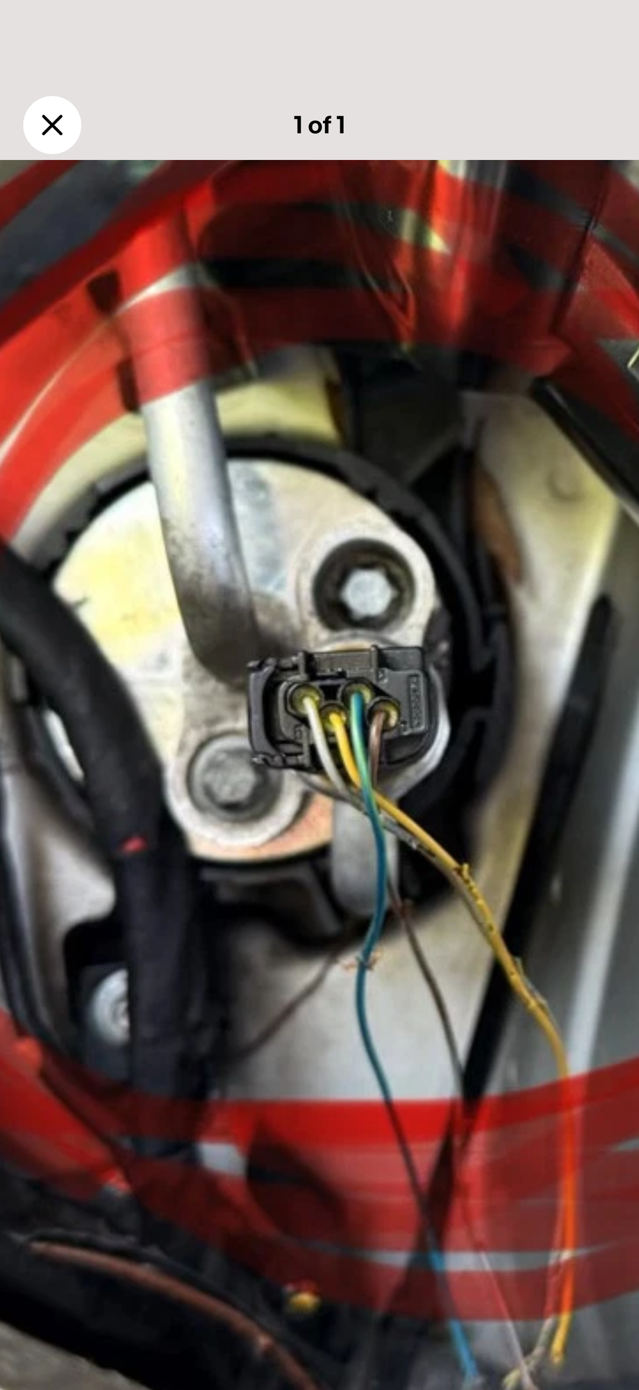

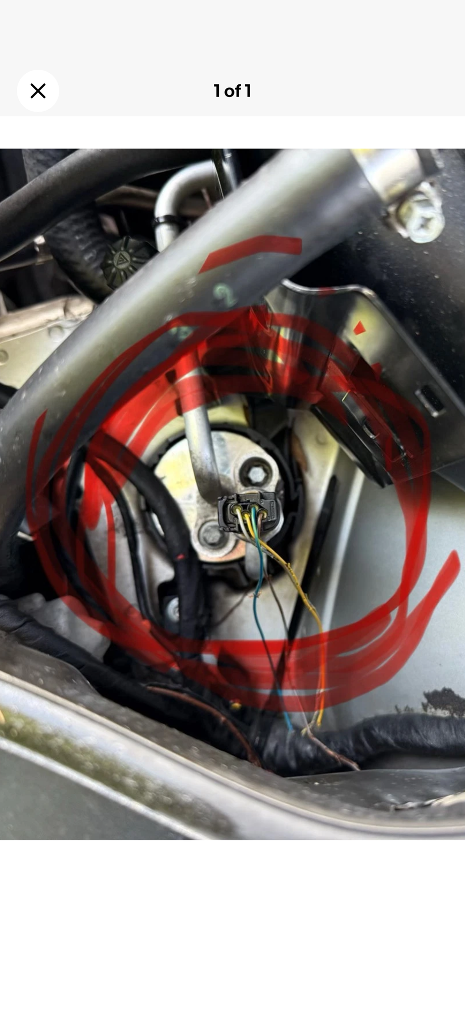

I bought this 2004SL500 few years ago from a private guy. The car looked nice inside and out side but with a few cracks on the lower part of the front bumper (which I did not notice it before buying it) My adult son did but did not think it was important for a deal breaker. Mainly because the car looked amazing well cared for without dents scratches and the engine also looked good very clean and sounded sound. Of course after a while the car started to have issues with the ABC system, no oil leaks of any kind or fluidsI saw on the floor or anywhere else to the present time. So I know I have to replace the accumulators very possibly even though I still can figure out how many the car has. I’ve done some investigation and found that some say 2 others 3 or 4 😵‍💫 I will do the work myself including the cracked bumper. So the car has been parked. Now I’m asking if anyone has an idea of what this part name is and what it controls. A big a rat was living in the engine bay and chew off the wires of this thing. If anyone knows and would like to share the knowledge I will be very appreciative. Also I know I will be asking for more help when I start to replace the accumulators. Thanks and happy Wednesday!
This part is located on the drivers side near the back of the left front headlight.

Accumulators can be bought from FCPeuro online, they will know how many the car has. That thing under the hood with the wires, I have no idea what that is, sorry!

That unidentified item is the receiver/dryer for the AC system. Wires are for a sensor which detects refrigerant pressure.
