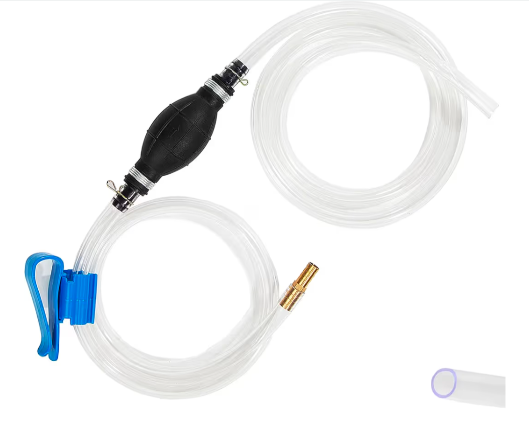

3) After removing the old filter, I extract and replenish the fluid in the reservoir. The reservoir holds ~2L, which is 50% of the total system fluid capacity. This step takes the dirtiest fluid in the entire system out of the picture before any system Actuations are introduced. This first extraction is also what goes into the first container, and is your first check for debris.
4) With the reservoir replenished with new fluid and a new filter installed, I'll perform a "Rodeo" to ensure that the new fluid is fully circulated throughout the struts, shocks and valve blocks so that any small pockets of dirty fluid (e.g. in the bleeders) are reached and cleared. The reservoir is then extracted and replenished a second time, readying the system for the fluid cycle process. The extracted fluid here is what goes into your second container, and is your second review of the debris in the system.
5) Cycle out the fluid in the system with the next 5L of new fluid. The two-step process above usually results in clean fluid coming out pretty soon. Be sure to never let the reservoir run dry and have at least a half liter of new fluid to set the level at the end.

HLG600 - Thank you once again for providing an extremely insightful post. As you have suggested, I will review the videos on YouTube to ascertain a sense of the process before proceeding. I am afraid my curiosity got the better of me this past weekend and I inspected the ABC fluid. There was some black residue on the bottom of the reservoir which I have placed on a white paper background. Would it be safe to assume that this is normal. How would you suggest cleaning the residue from the reservoir itself as access is noticeably restricted. I have attached a few of pictures for your review as well as a device that I have acquired to help remove the fluid from the reservoir. As ever, your thoughts would be very much appreciated. Many thanks.
