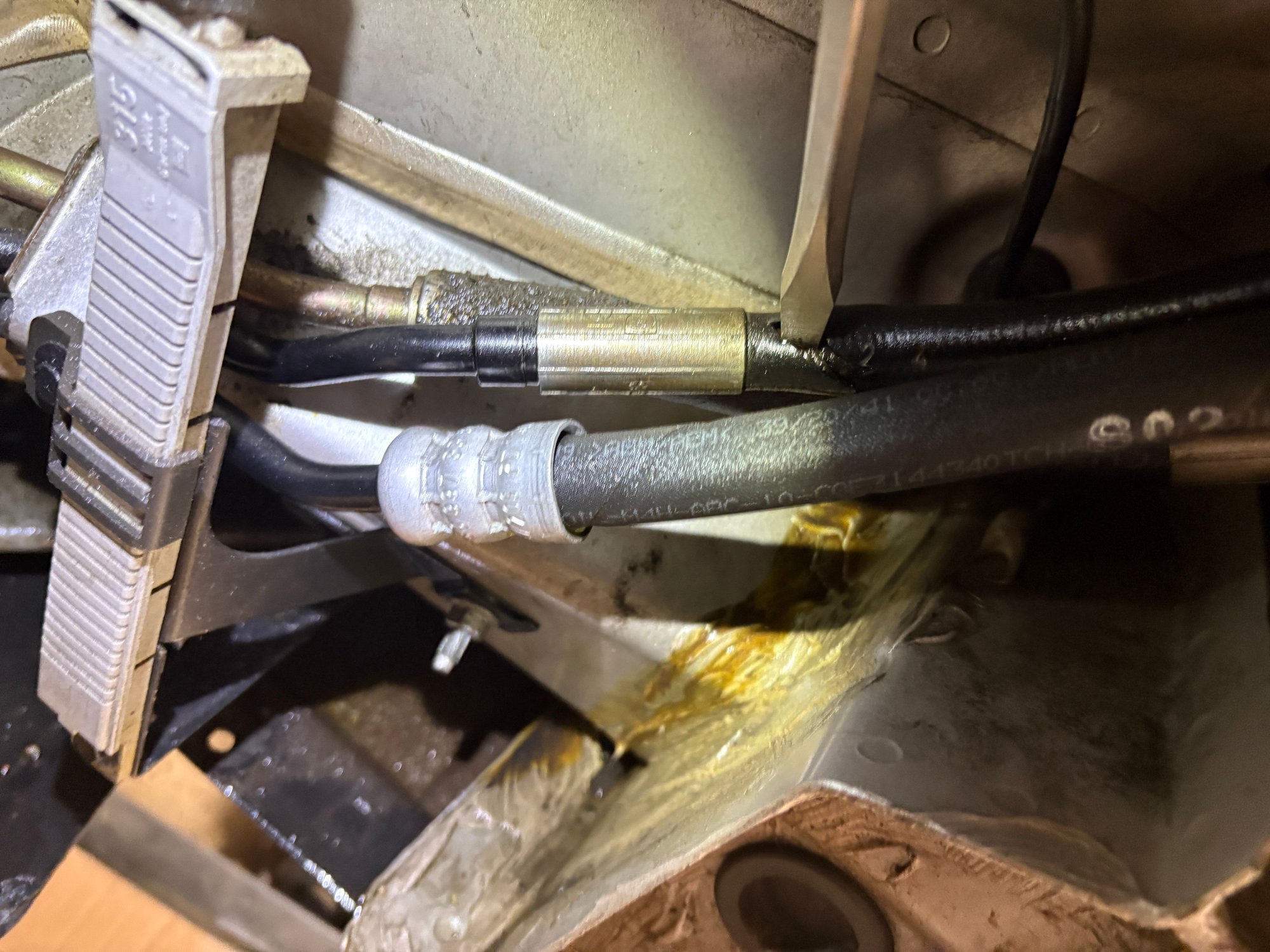

Driving at about 65 mph last evening, I heard a loud boom, and the red ABC waning came up, and I could see oil trailing behind me on the drivers side. I guessed it was a hose and I drive about 4-5 more miles at low speed, but very concerned about burning the ABC pump up, then had it towed home.
Sure enough, blown hose in the LF wheel well (see picture).

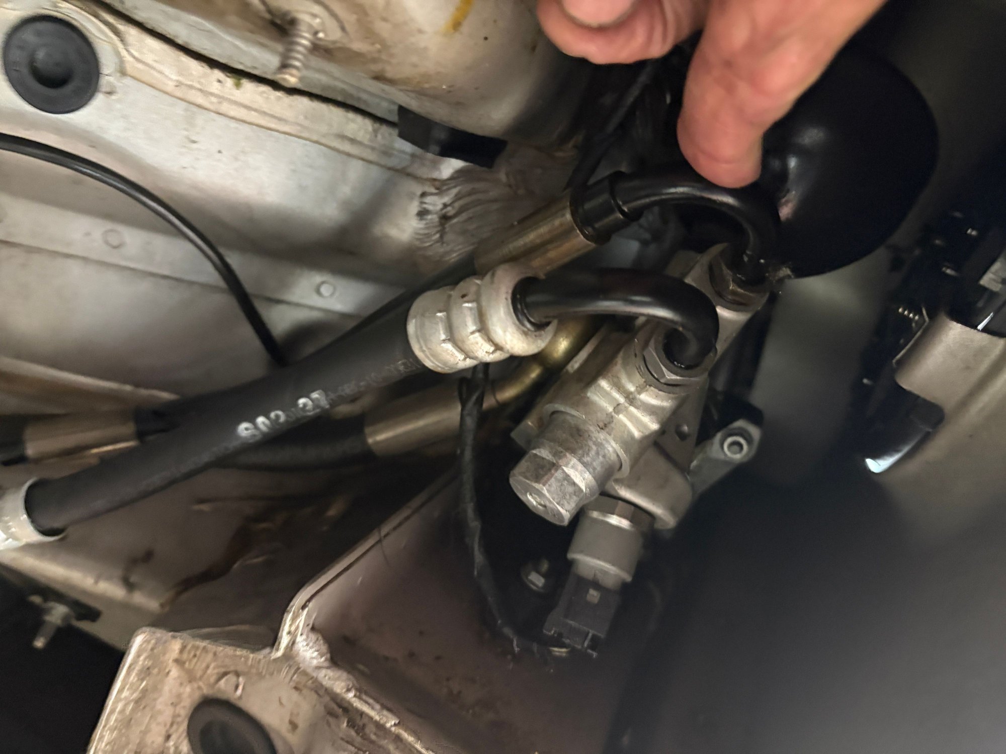

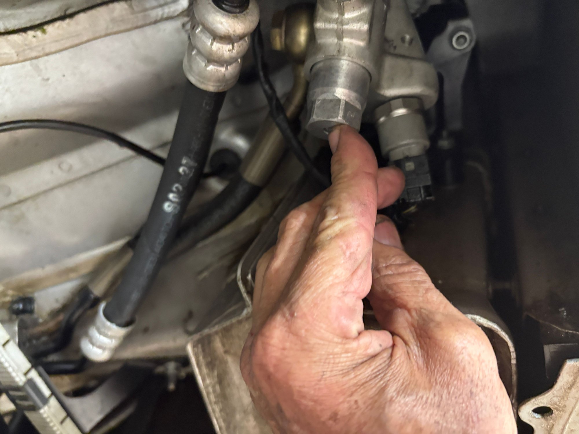

No problem to replace the hose but, I am wondering if it was just a 24 year old hose, or if the pressure control valve is problematic too? This hose (smallish) must be a pressure line (vs. larger Low P return) and seems to go into the manifold there with the relief valve (pressure control valve) in it (see pics). About 2 years ago when I was sorting out the system (all new accumulators and replacing a strut and the rear valve block, flushing the system) the return hose just in front of the blown line in the pics, blew to at that time, I never figured out how that line became over pressurized? (maybe it didn't ?) That line gave off a large boom too and I assumed it was a pressure line or became over pressurized. That led me disassemble and inspect that relief valve thinking that maybe the spring loaded poppet was seized or was otherwise sticking.........it was fine (and I'm an old aircraft hydraulic and valve engineer). If I recall I was then able to see the system pressure in DAS.......and it was normal (can't remember 1500 or 2000 psi. And it appears taht the blown P line feed into the manifold, then the fluid passes over the relief valve and out to the return (Low P) line noted above. The system has worked fine since.
So, I'm seeking others experiences in this regard. Do I have my facts straight? Just a new hose? Or a need relief vale too? Should I replace other P hoses too??? Are some hoses more prone to fail? Thats a lot of hoses. And concerns or suggestions about re-starting the system? Or just fill and let it self bleed?

Yes, I understand the role of the accumulators observing pressure spikes. And I replaced all 4 accumulators (or was it 3?) about 2 years ago. When I had at lease one bad one, which resulted in an ABC warning when going over bumps. That issue was resolved by the replacement accumulators.
There is an accumulator right next to the hose failure. It's located on the pressure control valve manifold behind the LF wheel. Could it have failed???

I hadn't reviewed it in some time and after doing so I have a number of things to check after replacing the bad hose, namely the small accumulator on the relief valve block that the bad hose feeds. This is the pump pulse damper and if its blown, then the pump would likely have beat that hose to failure. It was replaced in mid-2021 and less than 8k miles back, (car is an '03 with 81k miles) but it may be bad as I think I heard the Humm described in that paper. Plus I can just poke something in this accumulator and see if the membrane is present and firm. And I'll feel the hose in and hose out as described and expect to find a marked difference in the pulses if the accumulator is good.
I'll update my post on any findings.

I installed the new hose today. but before I did, I pulled the accumulator/pulse damper from the Relief Valve Manifold and poked around inside. I has a little metal like a rivet or such inside the port, likely to keep the membrane from blowing out of the port. It was solid when I pushed on it, and as it was still quite new, I decided it was ok and reinstalled it. For future reference, the bottom end of the hose/tube connects to a "T" underneath that's next to the left Cat, so not to bad a job..........of course as everything was oiled down, it was messy.
I was planning a fluid change anyway, so I set that up and filled the reservoir. Worried that I could have damaged the pump on my short few mile drive after the hose blew and the reservoir had been pumped dry, I also wanted to monitor the flow. It was slow to start pumping, and i started and stopped the engine in short intervals until choaked down a few quarts of oil, and once it did, then I finished the flush as normal. Put in a new filter, checked for leaks and then tried to feel the two pressure hoses at the Relief Valve Manifold to sense a difference in pulsation as suggested in the ABC Specialists paper. Whatever differences were there were pretty subtle......so inconclusive on that.
System pressure looked normal at about 198-195 b, and the system seems just fine.
So what did the hose blow? Possibly just old (22+ years), or maybe the accumulator/pulse damper that I replaced had been bad for some time and that fatigued the hose? Hope it holds up. Thx all for your inputs here.
