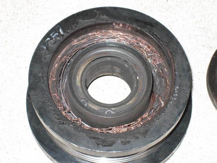

A year went by and then I got a call again, "Hey, remember that horrible noise a year ago?” Feeling defeated I dove under the hood to discover that this time, it was the electromagnetic clutch that had worn out and virtually disintegrated inside the supercharger pulley. Well, at least I wouldn't have to take the supercharger out again. Got a new supercharger clutch for around $260 but once I tried to install it I noticed that it was wobbly and not matching up to the pulley.
The shaft was bent. The heat from the slipping clutch had caused the plastic housing of the electromagnet to melt and the copper rubbed against the shaft generating enough heat to bend it. So, beaten down by life I proceeded to buy a new supercharger with clutch, fluid and everything but to my surprise, the price had now dropped to $869. The new unit went in like a dream and after replacing a fuse it all worked like new.

If anybody is interested, I can take some pictures of the two dead superchargers.

Please post pix as stated.

Pictures:
Attached Thumbnails Supercharger Adventures - Long Story-superchargers_low.jpg   Supercharger Adventures - Long Story-supercharger_gear_closeup_low.jpg   Supercharger Adventures - Long Story-supercharger_clutch_closeup_low.jpg

Thanks for the pix.
Im still trying to work out why the gears failed??
