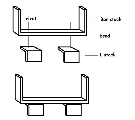

I made my own bracket out of aluminum bar stock. It's a very simple U-shaped bracket, two bends in a vise. Then I drilled holes to match the side of the changer. The bottom of the 'U' runs beneath the changer. I pop riveted an L-shaped aluminum piece onto the bottom of this U, then used sheet metal screws to fasten the L part directly onto the SLK steel channel, through the plastic trunk liner, below the changer. The removable panel covers these screws. Most hardware stores stock this type of aluminum. Costs only a few bucks.

DickB, can you post a diagram of the bracket and where and how it installs in the side compartment? It looks like it is mounted on the driver's side in your picture.

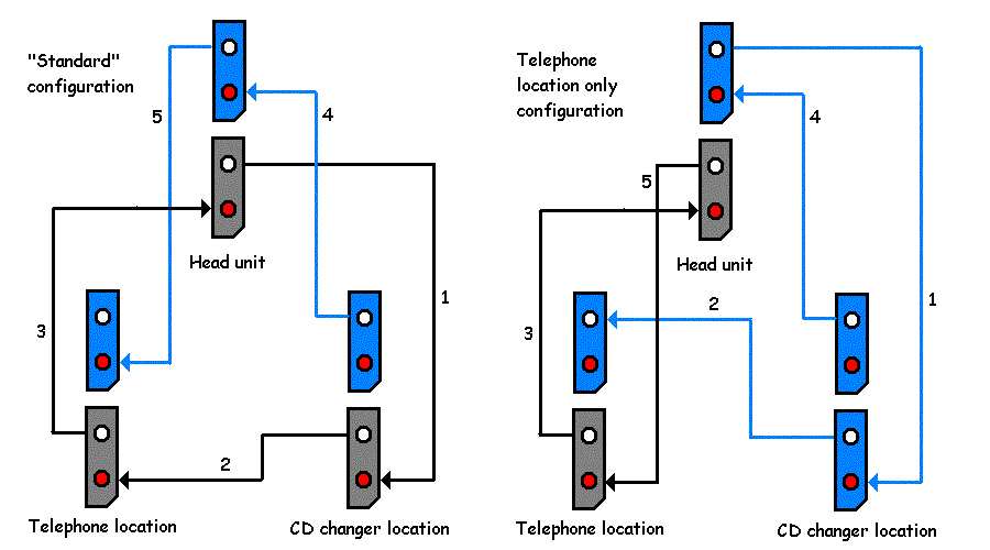

ALso, does anyone have pictures of the stock CD-changer installation? I think I only have half of the bracket. I have the part up against the plastic panel that covers the roof motor, where the wires come out. Also, when putting the two HU wires in the same plastic clip, does it matter what order they are in?

Here is a diagram of the bracket.
Aluminum bar stock and L stock from a hardware or home improvement store.

Position of the fibers matters.
Connect per the diagram. 'Standard configuration' is how the SLK comes from the factory I think. Connect per the right diagram.
