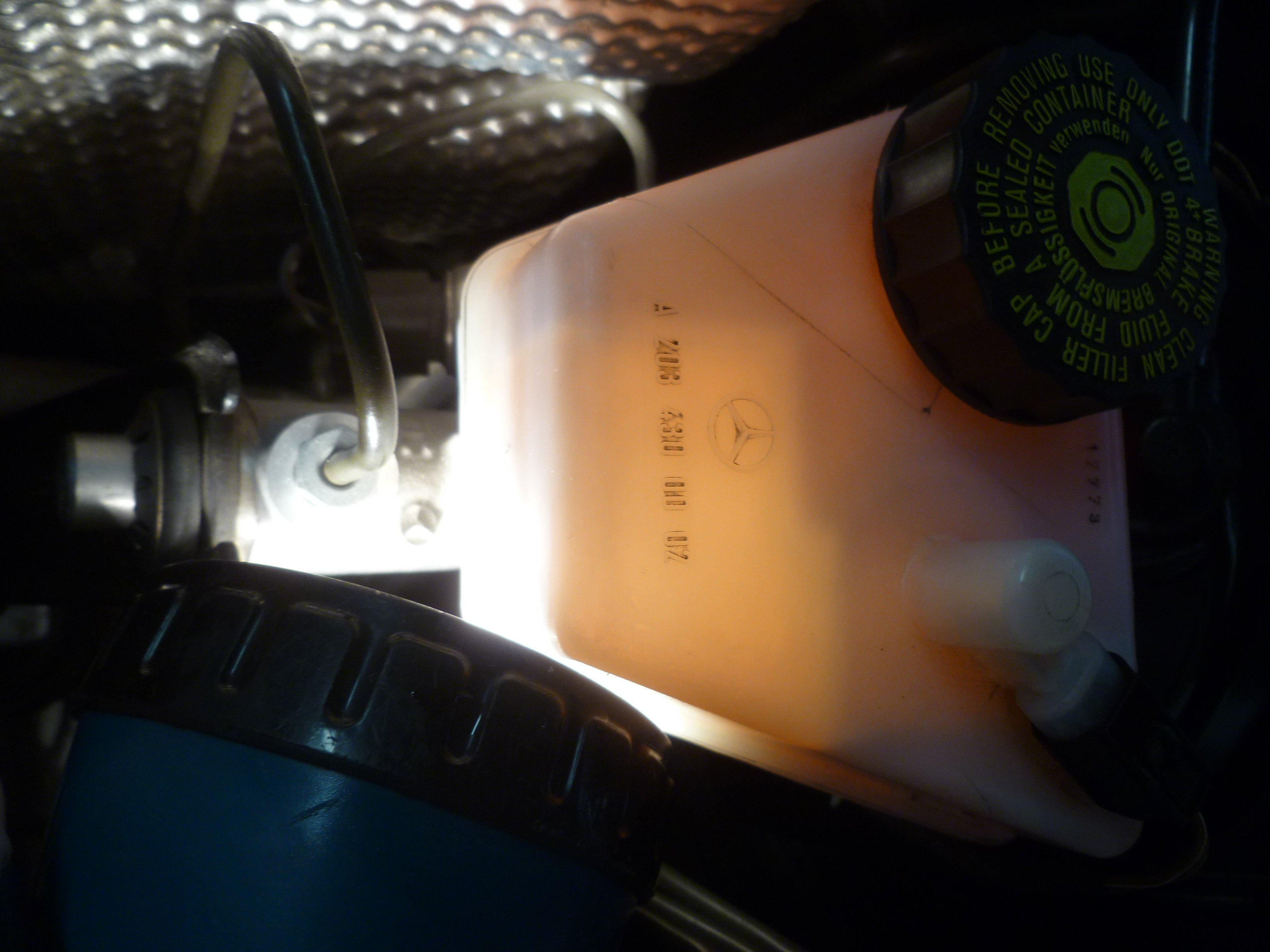

new guy here with 08 Crossfire aka Slk320
the brakes were spongy when I bought the car last month
i replaced the rotors and pads and have bled thoroughly with almost 2 liters of pentosin Dot4
always got air, finally went to the Speed-bleeders and I have to say that they are awesome.
I stayed at the business end while my wife pumped the pedal
we did all 4 last night with the speed-bleeders and once again this morning, and got a fair amount of air out of all wheels.
I did get 2 good size air bubbles out of the lefty rear after sitting all night.
So, with that said I can pretty confidentially, say that the system has been bleed and that there is no air.
The pedal is better, but i feel that it is still spongy (not as much)when i run the engine.
with the engine off I get a high hard pedal.
the purpose of this post is to get some feedback on the photo of the reservoir back lit by my flashlight.
the reservoir is full but i can clearly see a compartment in the front that is topped with about 3/16"-1/4" of air, is this a normal situation?
Can someone in the group put the flashlight to the side of your reservoir and tell me what you see?
thanks

Looks like you have air in the ABS Module, very difficult to get out without taking it to a place that can Autobleed the ABS Pump.
