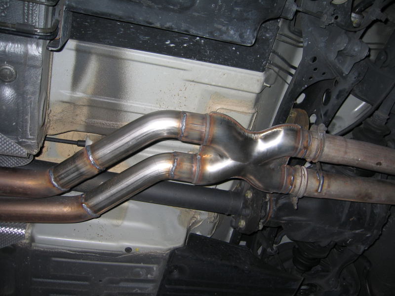

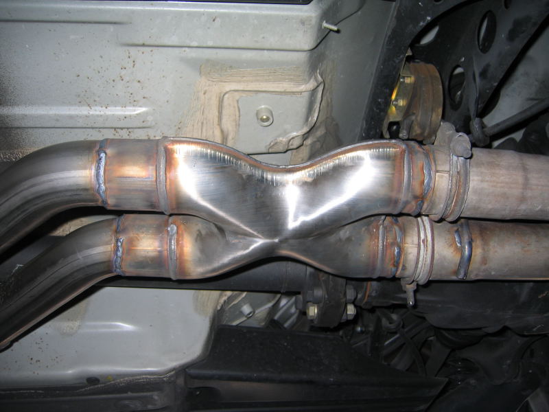

New mod X-Pipe! I found a muffler shop near me that does great work, and I like the way it came out. The sound is more like an AMG should sound like. Thanks guys for all your post on this mod.
Here are the pictures:

Hey good to hear that you want this great mod. You need to get the x-pipe and 2 45-degree bent pipes. You also have to tell them how you want this install completed. They just did my car so they will remember it. Arrow Muffler 14545 NW 7 AVE. Miami, FL 305-688-0574 they've been doing this work since 1958 and they had a race team for many years. The neighborhood isn’t the best but as you see there work stands for it's self. Print my photos and take them and show them what you want. They charged me $80.00 and took about 30 min. Enjoy the sound!

Buy it on ebay theres a bunch on there as well as the SS pipes. They have SS pipes at the muffler shop as well, but I don't know how they bend them. Maybe go by and see what they offer you before the install.

I purchased my MANDREL BEND 45 DEGREE 2.25inch 304 SS pipes from here:
http://cgi.ebay.com/ebaymotors/MANDR...QQcmdZViewItem
And the MAGNAFLOW 2 1/4" 2.25" Tru-X SS X Pipe. Here's one:
http://cgi.ebay.com/ebaymotors/Magna...QQcmdZViewItem
I love the sound so much now this is the best mod I've done to date!
