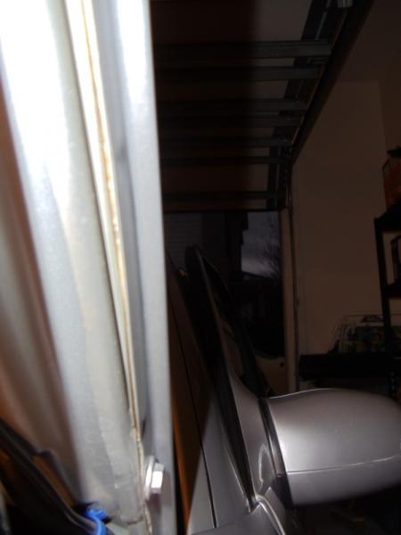

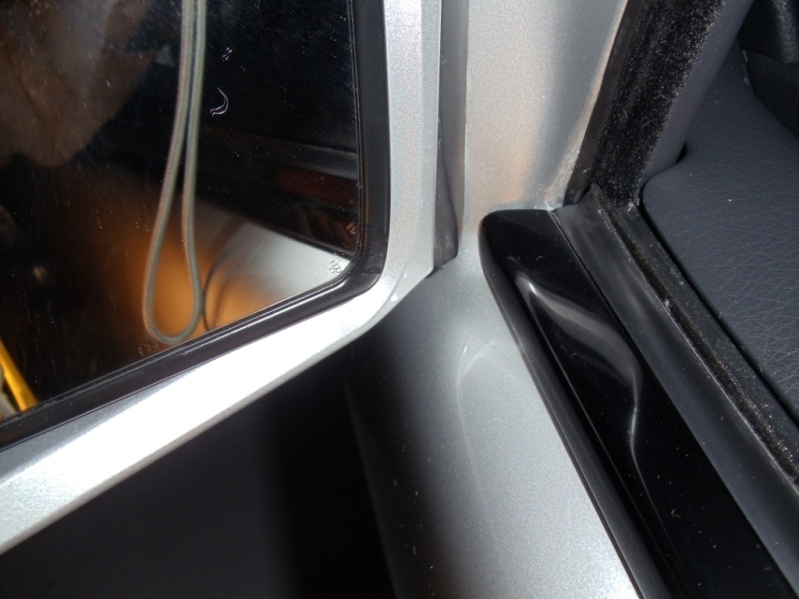

Okay, this thread got me wondering so I went on a Identify and Repair mission. Now my car has been a garage queen most of its life (albeit in Florida mostly) and only has 30K miles. I had noticed rust near the mirror on the driver’s door and had already repaired that area. Picture 1.

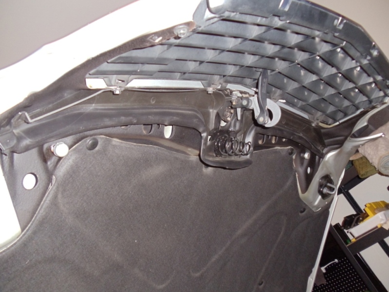

I also had taken off the grill previously and I found rust underneath the rubber weather shield. I removed all of the rust and used Naval Jelly to eliminate the rest, then painted that whole section with several coats of Rustoleum and then gave a coat of undercoating on top of the paint. I think this covers that area and I don't expect any more problems here. Picture 2.

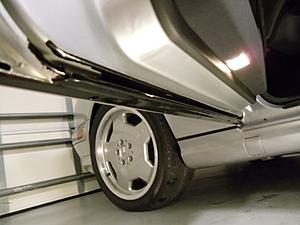

Now I have removed the weather seal on the doors and I am just astonished at how Mercedes has created such a mess. Pictures 3-4. This is the worst but all doors had similar problems.
An area that I have noticed but have not yet attempted to repair is the hood near the springs. Picture 5. This again is just stupid on Mercedes part. I have a W124 300CE and the hood on it is sealed all the way, on the W210 it is sealed only half way and the rest is beginning to rust. Will fix it, just will take a little time.
Having read the HORROR stories of the front springs falling out from rust I gave that area a good inspection and then layered on some undercoating just for good measure. Picture 6.
The major flaw here is obviously the metal and the paint but also just sloppy in applying the sealant to the point where the weep holes were clogged so the water had nowhere to go, RUST.
I will be repairing these spots over the next couple of days and will post my repair pictures, any suggestions will be welcomed.
I also have rust under the rocker panel so I have attempted to remove one of the panels with no luck. There are four screws in the rear, three in the front and a bunch of the plastic snaps, however after removing all of those I am at a loss as to what to do next. Someone has to have removed these panels or knows someone that knows the trick! HELP Please!!
