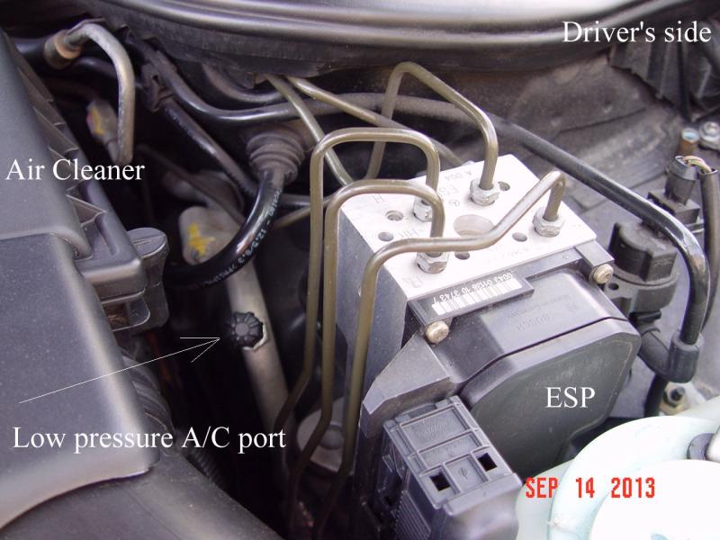

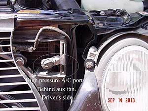

Does anyone know where the AC line is located? Maybe someone can take a picture? Can't seem to find it.

under windshield washer

Low pressure port or high pressure port?
Attached Thumbnails Air Condition(AC) Line location?-dsc04860.jpg   Air Condition(AC) Line location?-dsc04861.jpg
