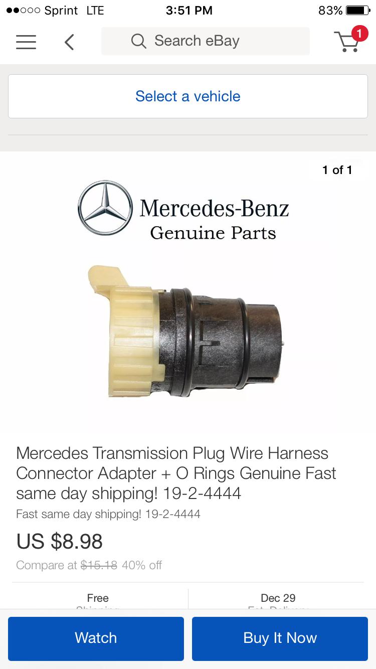

w210 AMG or S213
Read this, replace the connector o-rings on your transmission and clean off / dry out the tcu/ecu.

Old Dec 19, 2015 | 03:52 PM
1999w210e55amg's Avatar
Joined: Apr 2015
Posts: 91
W210 e55 amg
Is this what your talking about
