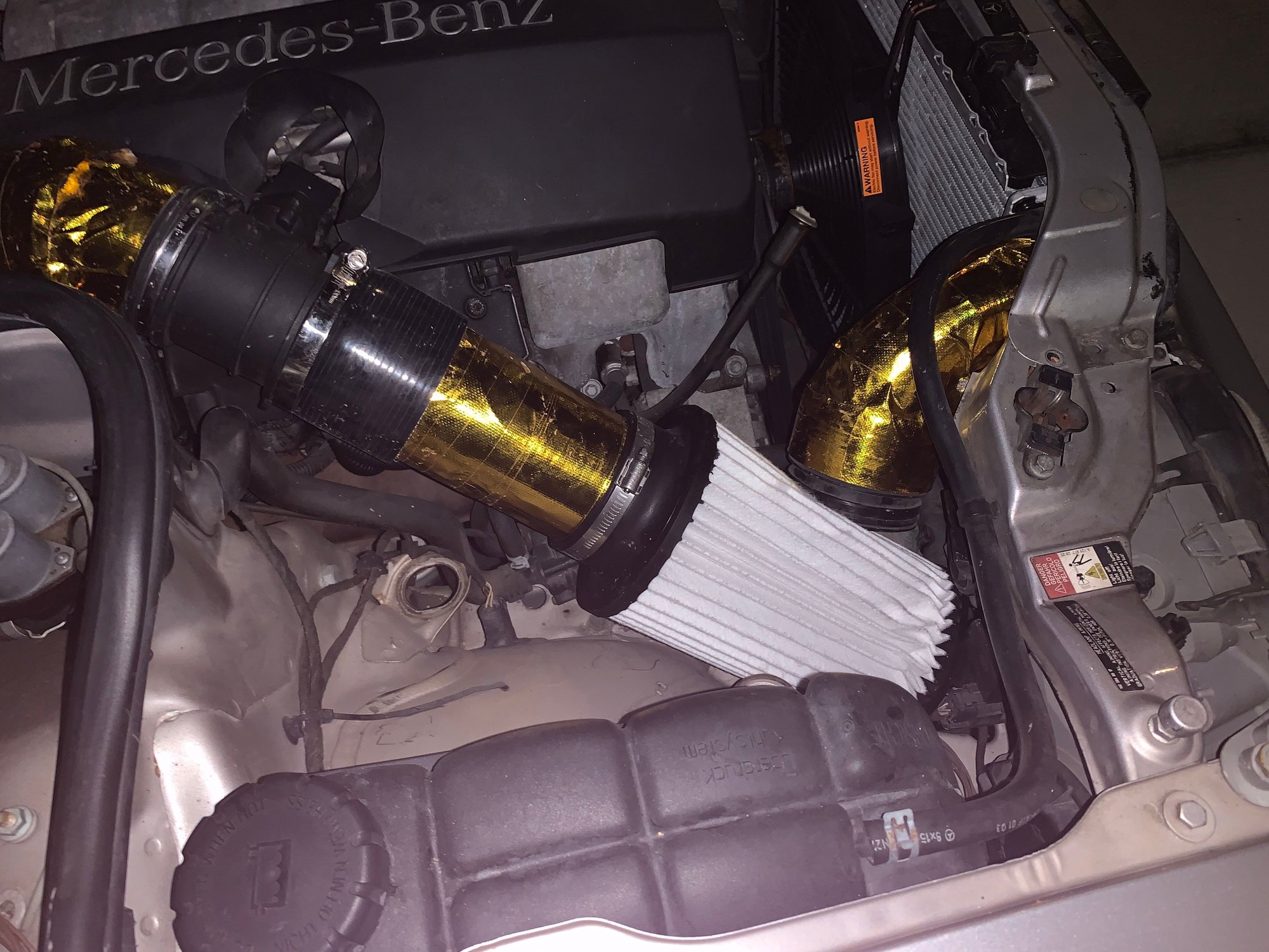

Originally Posted by eurochargedw210
Just installed this today
3.5in 90° silicone elbow
3.5in 3in silicone coupler
12in 3.5 carbon tube
45° 3.5 in carbon tube
went with a aem Brute force. 9inch long
It also has the gutted elbow to the throttle body from Speed43
Hopefully will get it on the dyno this weekend.
Also going to make a heat shield this weekend.

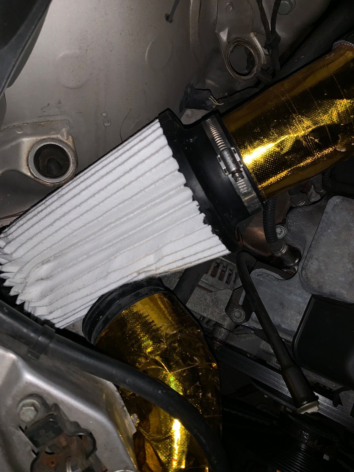

so i went with this filter , the temperature outside was 62° and my IAT were 70 degrees , the temperature does rise quickly when you’re at idle but once you get moving it cools down very very quickly back down to 70°F, i’ve come to the conclusion that IATs don’t really matter very much. What matters is getting more air into the motor , it’s a massive increase in power especially while moving down the highway, kinda feels like a small amount of boost almost like you’re being hit from behind by another vehicle and pushed. from my experience, it feels like about 15 hp or more. So even with increased IAT, it’s still a massive increase over the stock box with a k&n filter in it, I may fab off a heat shield for it as well, and the gold tape works excellent, after an hour of driving stop and go the tape was cool to the touch.
It is great to always have the lowest IATs for sure. But most N.A. cars don’t care about the IAT
so I built a heat shield for the filter but it seems to have made the IATs go up higher, so I removed it in the temps drop back down while I was driving

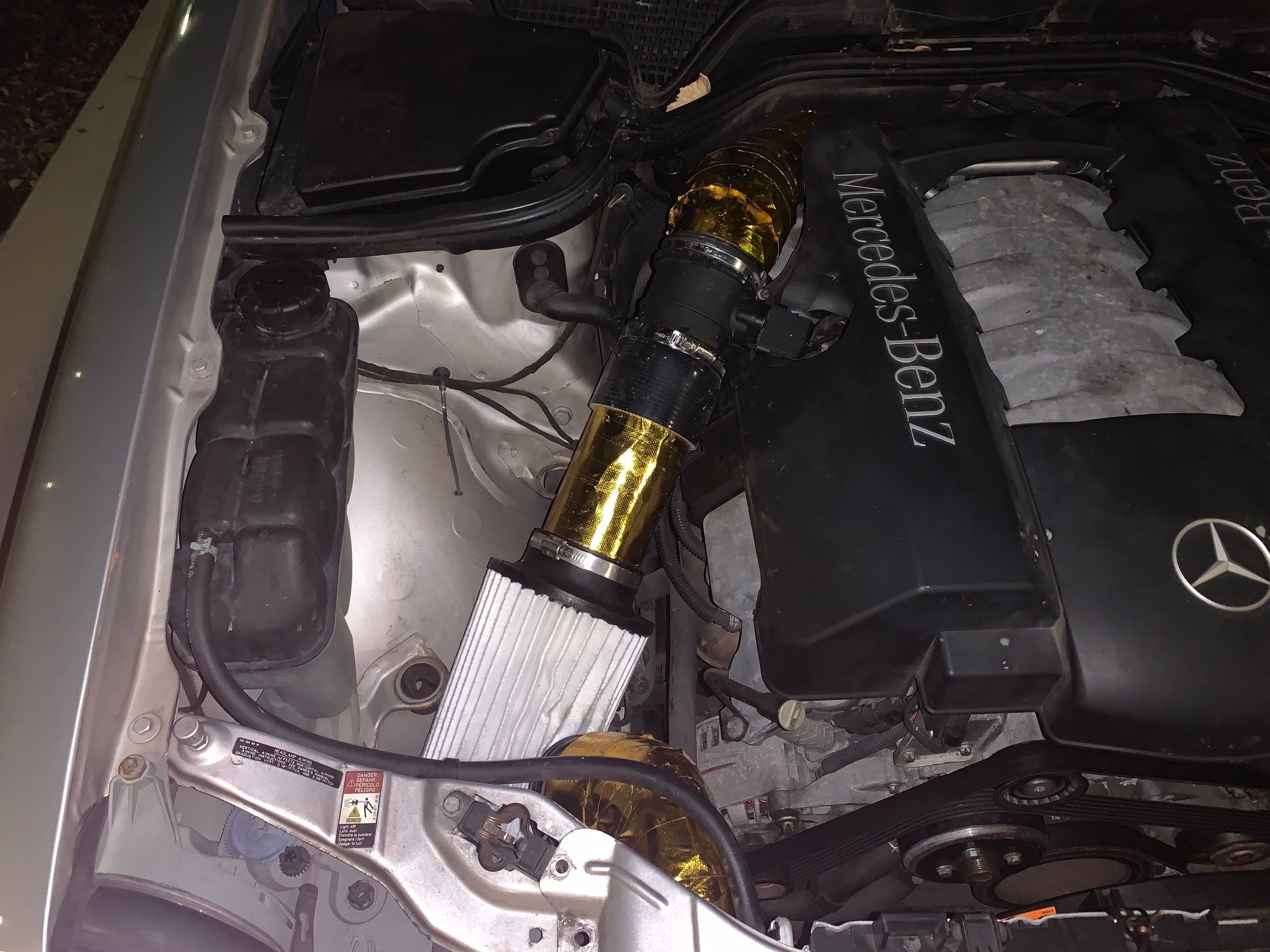

is there gain in removing those baffles in the boot that clips to the throttle body?

E430
threw the stock box back on today and performance was more consistent and car ran smoother. I’m convinced cold temps may actually be better!!
but hp is down compared to the cold air intake
New pic why my heat shield made from the exhaust heat shielding from a w211 I cut into shape, also riveted a heat shield products, flexible heat shield to it. Exhaust side of the shield will get to 160 to 190°, while the air filter side is 130ish
Also my new AFR filter
make it like this, with the ducting and heat shield. I had like a 3rd version after this with a 6in air filter and a velocity stack
heat shield made my temps go up a lot
