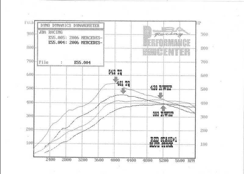

To all Dyno graph experts, please comment on this graph since I dont know how to read it. Thank you all in advance.

that dyno reading seems weird for a E55
Tq is way late and never cross he HP line. I think the peak TQ should be somewhere in the 2000-3000 rpm range and slop down from there. HP should cross somewhere around 5500 i think or less. something is not quite right there

Looks like you did a stage 1 mod and picked up 35 hp and 81 lbs of torque.
Pretty darn good.
You should certainly feel that difference.
What work was done on the stage 1 and what make? Pulley and ecu?
Torque does peak a bit high, but the tq and hp lines do cross. With the stage 1, she's a monster.
Pretty darn good.
I had Renntech stage 1 installed last week(ECU & PULLEY). The ESP icon lights up all the time whenever I stepped on the gas and she starts to go sideway. I definitely can feel the additional HPs and this should be the FIRST MOD to any E55 instead of the cosmetic mods IMO.
What should the correct graph of Renntech stage 1 be? Something is wrong with this DYNO or something is wrong with the car? Thanks again.

dyno dynamics dyno might be the issue. Not the car. Operator could have applied the load on the car I guess.
I also had my car dynoed on the Dyno Dynamics Dyno. My TQ peaked way sooner. I wish I could find it to post ..........

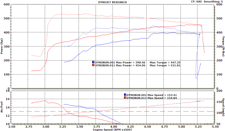

Here's mine on a Dyno Jet for comparison.
in the top right hand corner what does this sae smoothing 5 mean? none of my dynos have 5s they are at 0! james what is the difference? does this mess with the out come of the numbers?
ROCKETW19,
SAE correction Factor basically is a way to keep dynojet numbers constant. What this allows is for you to be able to dyno at another dynojet and get similar numbers. The SAE - corrected #'s use this mode to correct the hp #'s using 77F as temperature, 29.23 as the barometric pressure and zero humidity.
Rocket, the smoothing number affects how jagged the lines appear in the graph. A smoothing of 0 will lead to more jagged lines (more data points) and 5 is for smoother lines.
The CF is correction factor and you have a variety of choices, such as SAE, DIN, EEC, STD and None. My understanding is that this tries to account for US vs EU standards and atmospheric variables.

2K6E55 look at the dyno that was posted. It doesnt matter that it is a dyno jet. Do you see how soon the TQ peak is in that dyno. Every other dyno I have seen has had TQ peak in same area for a E55. The TQ curve in your dyno is about 1000+ rpm late.
also notice how in the dyno jet dyno the lines cross at about 5200-5300rpm. The lines do not cross at all in your dyno.
On 2K6E55 his curves actually cross right after 5200 RPM. AS for the late tq numbers that's actually really odd as our other graphs have TQ peaking between 3200-3400

I wasn't meaning to imply that the bump was low, I was talking about his baseline numbers. I'm used to E55s running closer to 420 at the wheel. I sure don't believe the 469hp part, since I've smoked plenty of other 55s. Jeff's description of the butt dyno is good enough for me to know that the pulley and ECU makes a difference as does the other feedback I've gotten from RENNTech customers. That is why i am so curious to hear about Jay's ride.
The TQ curve looks really off to me. I'm used to E55s having MUCH more low end grunt and it barely tapering off. This run looks more like an M powered car. I wonder if there is some reason why Jeff's looks like its dumping at higher revs? Maybe a fan, but also maybe the car? was he on the 19s, still?

so James@Creative? When did the HP and TQ cross? If I am going by the dyno posted it is after 6000rpm? The lines are not crossing in the dyno posted
The numbers seem to be fine its just where they are

Hp and Tq numbers will always cross at 5252 rpms.

The crossing we talk about is actually different. The thing to keep in mind is that all runs are relative to that point in time. Setup, calibration, etc can be a huge factor. I guess my point is that there are such gross differences in 2k6e55's dyno run as compared to what we are used to seeing that analyzing the nuances is a bit falacious. As Jeff said, something ain't right. If its the car, it is likely a simple cooling thing. Other than that, he just got a pretty clean bill of health. My guess is that something is odd on the dyno setup and run. In either case, we can see and he can feel the Stage 1 mods. I would just personally like a cleaner dyno run.
