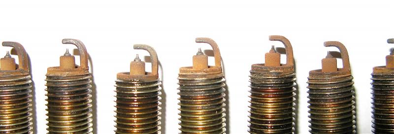

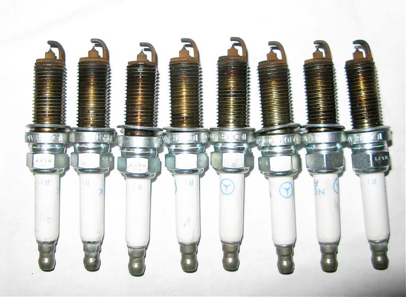

ok here are the pics of my plugs that came out a couple days ago at 23500 miles

Unusual reach configuration on the '63 plugs. Where you able to source aftermarket pieces?
Their coloration looks to be a little dark, but that could be due to extended idling or an engine that wasn’t fully warmed up and/or run on the highway before swapping them out. Surprising amount of deposits evident. Is it consuming any oil?
Perhaps it simply needs to spend more time in its element - at WOT.

Car is driven on hwy daily. And was driven more then 45 min on hwy before swap out. Engine has never had a consumption problem with oil. No couldnt find anything aftermarket so just got a fresh set from dealer and gapped them all to same specs. Car is running much stronger now then before. I tend to go WOT fairly often.

Thanks for the pics, but it doesn't look too bad

Thats not too bad an idea. the plugs look terrible. Gaps were off all over the place deposits/corrosion all over the arcs.
My recent Dyno sheets under the 63 thread are from about 2 weeks ago with the bad plugs. might go back to the Dyno this week and rerun it on the machine to see if there is any difference in numbers. Gotta see how busy my week is. The following monday I am going to MIR to do some runs.
Car definetly feels a lot stronger in the first 4-5k rpms with the new plugs.
