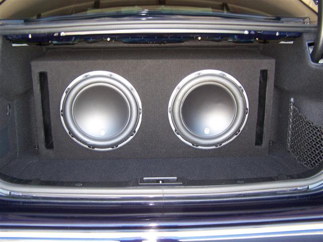

Search the Forums. Here's my solution for the weak H/K lows. There are some amazing systems in some E55s here. From mild (mine) to wild...Search the Forums

is that all you have? stock headunit, and speakers?
How does it sound?

Mines is all tied in to the COMAND. It's a simple setup with 2 JL Audio amps, Focal K2Power speakers front & rear and the 2 JL subs. The speakers drop right in to the factory locations in the doors, everything comes out nice & easy at the end of my lease. A decent system for a leased car and blows away the factory H/K crap. The Focal speakers sound amazing, and bass is totally ridiculous. I won't win any awards, but it is more than adequate for my needs.

The factory sub (remove immediately) leaves a nice cutout opening for plenty of bass to enter the cabin. Believe me, the opening is adequate, unless you want to start cutting. Get lots of DynaMat to squash most/all the rattling from the rear deck.

Torquey: that is the exact kind of system we do in the benzes, love the focal's, would go with audison amps instead of the JL's (much cleaner) but i would never touch the Cleansweep (POS IMO), the audiocontrol LC8 is sufficient and you can use that in conjunction with the EQS, definitely cut signal to the center channel. That speaker is facing you, and it's mighty annoying.
