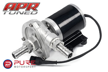

i'd like to find out who makes this pump... looks like good quality, but for $899 it's way overpriced
http://www.purems.com/Products/MS100...ormance-System
