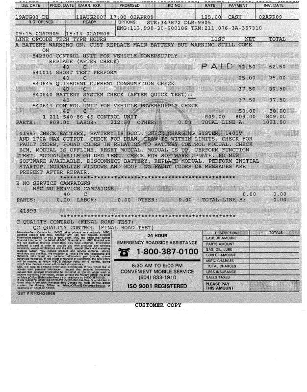

Had the same problem. I replaced the main battery in the trunk and warning light was still on. Car went back to dealership, they determined the problem was a bad battery charging circuit board. Cost of repair was $1162 canadian including taxes.
