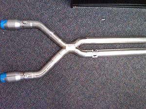

Once the first mod starts, it never stops. Plan for the future and always build your mods around doing more. If you don`t, as the mod virus hits, you will just keep re-doing and exapnding what you didn`t do right in the first place.. This waste $$$$$$.
Here is a mid pipe that I just built to go onto headers, with race cats. Never touched my stock AMG exh., until it was ready to replace it fully. Was tempted many times to franken hack it up to gain a few ponies but experience says to fight the mod virus and do it right !!
