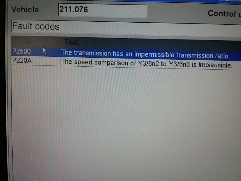

I read the trans codes and got the following two:
Afterwards, I reset the adaptive settings and things and things appear to be much better. I'll keep everyone posted on long-term effects.
Thanks everyone!

Just a heads up that code 2500 is often not a good sign.
First thing my tech asked me when I thought I was having tranny trouble.
He asked, "Did you get ratio impermissible on your Star? That usually is not a good sign. "
Hopefully adapts reset is the only thing she needs and everything goes back to normal.

I had the same issue, same codes. Usually the filter gets clogged, then the electrical plate shorts out. Easy enough, trans flush, remove and replace the electrical plate on the valve body and refill fluid to correct level. Should take you about 3 hours. Good luck!

socali.luv is correct. with those two codes, the conductor plate on top of the valve body is the cause. If your trans problems come back replace it.
