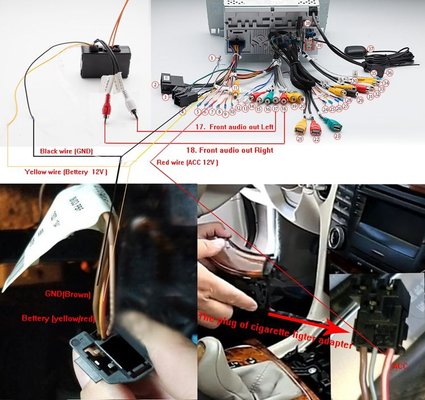

Thank for response drothgeb! Can you tell me "step by step" how did fix it?
I don't know what the pioneer wiring harness looks like, I installed the extrons unit. But there should be serperate aux power which needs to only be on with the key (ACC or AUX 12V labeled something like that) and also a permanent 12V source wire that does not shut with the key (labeled power/battery/etc).
