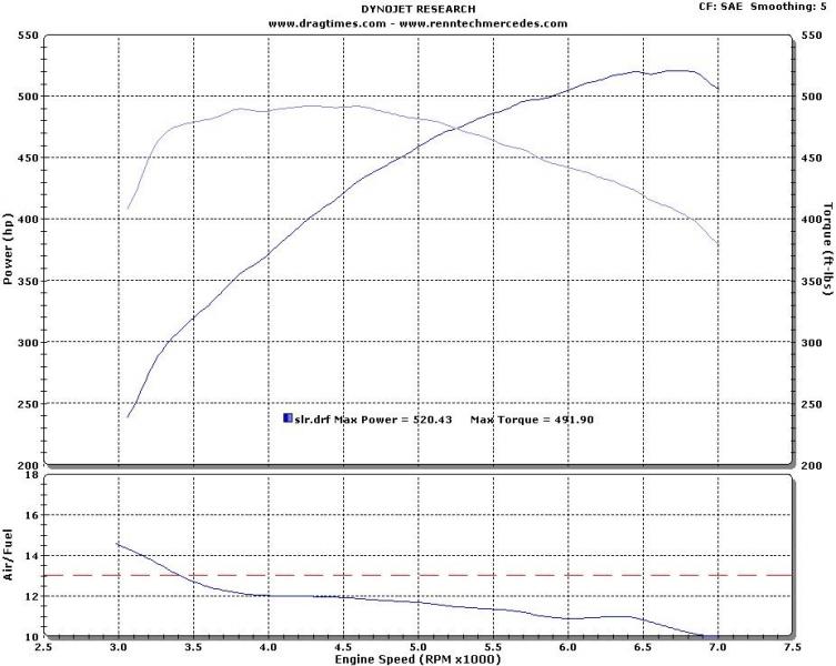

Stock SLR Dyno Sheet:
Pulley / Tune (Renntech)
So I think the 600 figure is a little high, but beyond that, the intercoolers make a huge difference in airflow and exhaust is less restrictive. They are getting more boost, but I don't know what the method is, likey gearing.
With the new intercooler setup, new heads, some larger TB's (100mm+) I think we will see some 600+ HP 55's in the near future. WAIT!! Exotic Metal is already there!!!!!
The 630whp car has more than just a pulley and tune. It also has headers and some other exhaust stuff and God knows what else.
