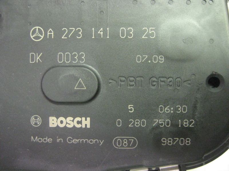

Part number of the OEM TB

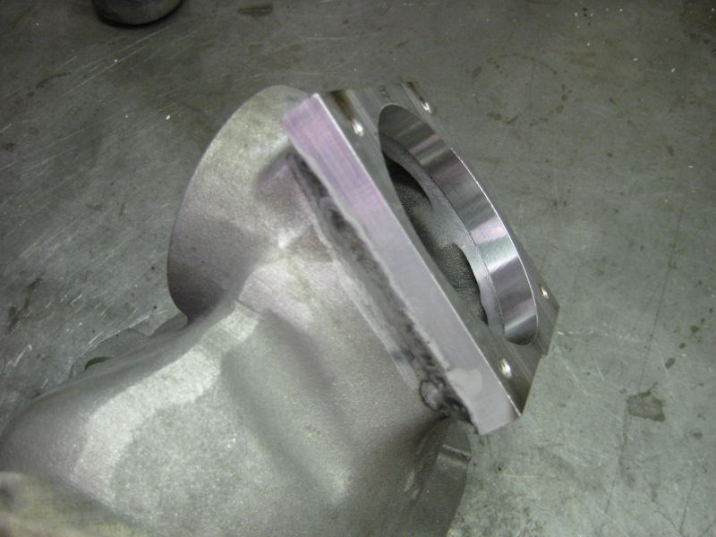

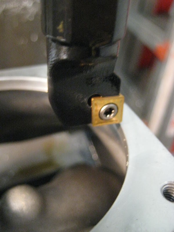

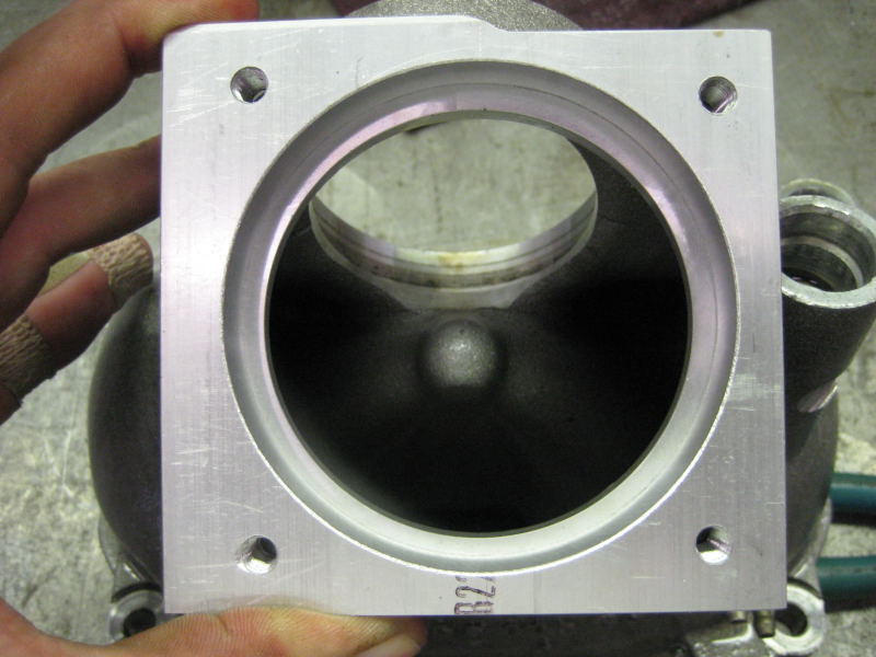

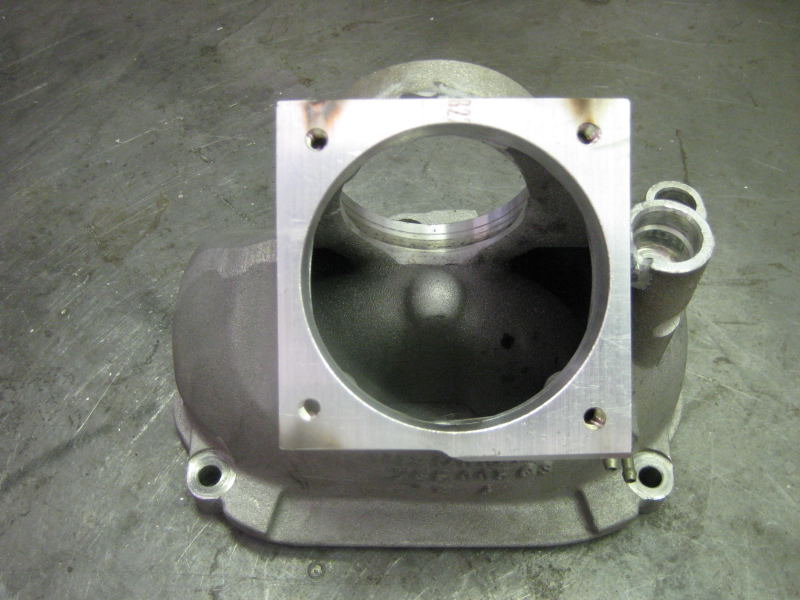

aluminum plate and started making the adapter plate needed to fit onto the stock supercharger snout:
Using a hole-saw, I cut the throttle body inlet hole undersized, just to remove most of the meat:
Then used a boring bar to bore the hole to size:
Here's the finished product with holes drilled and tapped:
Here's the stock supercharger snout. I cleaned it up a little and removed all the miscellaneous fittings and other fun-buttons:
A good visual to see what 74mm looks like compared to 82mm:
I made a little jig to hold the snout at the right angle and got busy with the boring bar again. Indexable carbide cutters rule:
Tack welded onto the newly bored supercharger snout:
All done:
