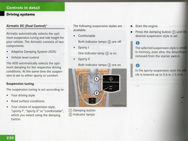

Here is the E class Owners manual, FWIW pg. 238 is the ski pass-thru storage in the E.
No reference to change of ride hight at motor shut down or locking.
I would love to see a vid of this "dumping air"

I would assume it would be much the way the wife's rover lowers itself.
Old Jun 30, 2013 | 03:07 PM
Yacht Master's Avatar
Joined: Oct 2006
Posts: 3,642
Likes: 13
From: Caribbean/Florida/Colorado
E-ZGO 53hp., 1999 E 430 sport, 2004 E 55, 2008 Tahoe LTZ on 24"s
+1 ON the RR oh and the Citroen too.
