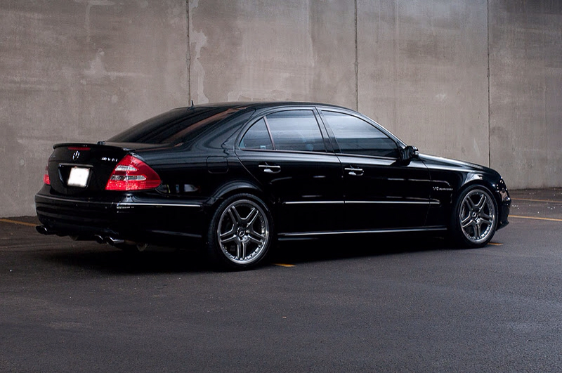

Hi guys. Im looking to get these rims i uploaded. Idk what would be the best tires (size) to put on
Any suggestions ?

Those are 19s from the 65 series AMG's (SL, CL, S, etc.) 245/35/19 front and 285/30/19 are the optimal sizes.

I want my rear to be like as wide as possible and i want all of them to be high. Do u think 35 front and 30 rear is the highest i can do with my 2004 e55

I'm running 255/35/19 and 285/30/19 with no issues looks perfect ride is good

Interesting. I have the 65 wheels on my E55 and was told 275/30/19 was as wide as I could go out back. Maybe it's because I'm lowered?
Why is it 35 front and 30 rear?
If ur lowered , its doesn't mean ur rear cant be wide. Ny opinion... I might be wrong

I have cls wheels and I fit 285 rears and I'm also lowered on coil overs
No rubbing at all? Even if u turn ur wheel all the way?

My last E55 was slammed on 255/35/19's and 285/30/19's and I NEVER rubbed under any circumstances. Thinking about going 295 out back this time.

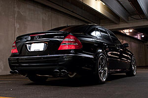

Which rims should get? Cant decide;(((
