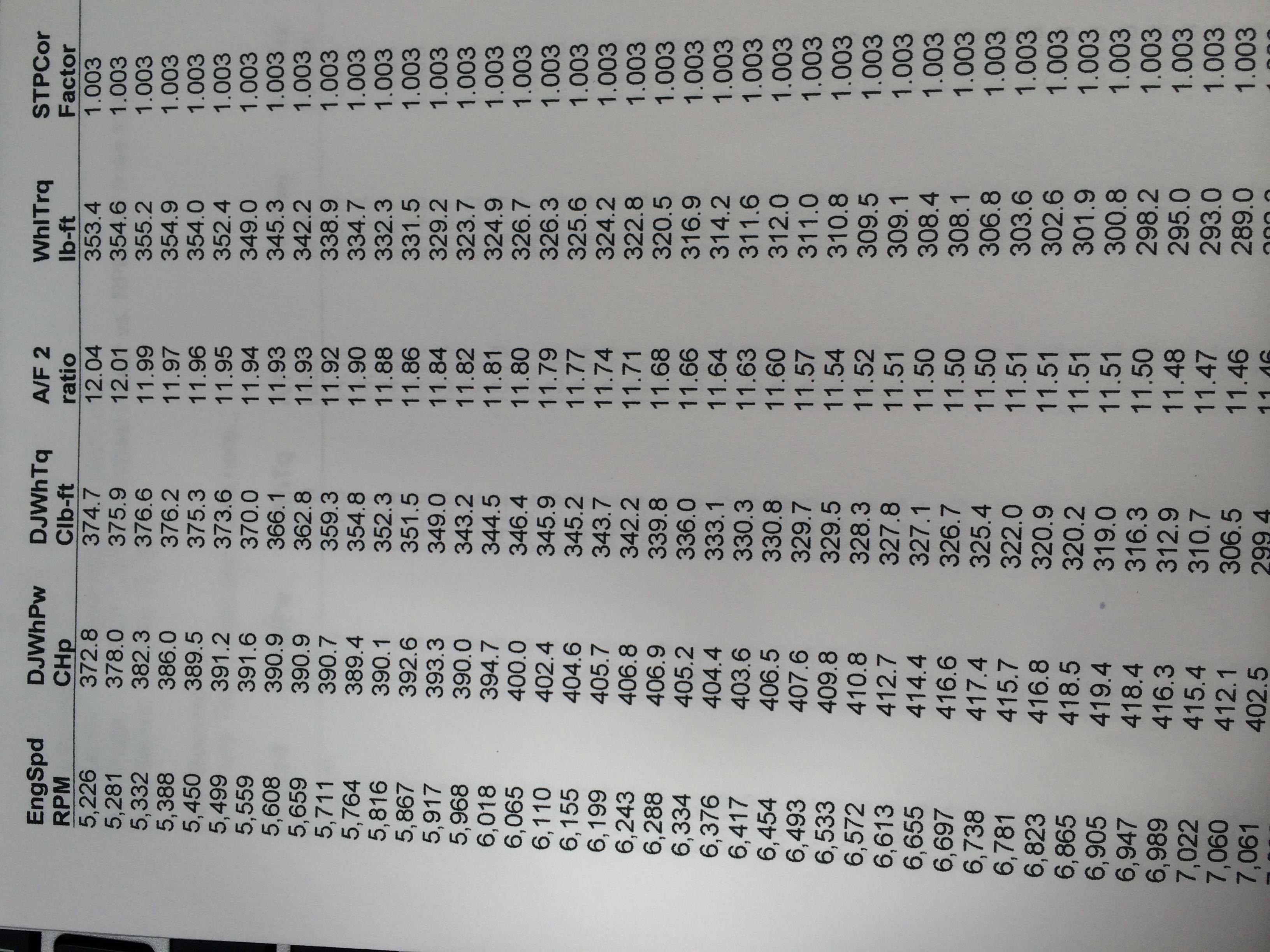

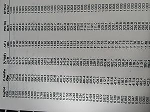

dyno update
so here are the results of the dyno. 419 hp and 375 torque. guys on the dyno said my peak is weird and it's plateauing and running rich. Contacted guys at kleeman and they said it's not rich and without knowing prior dyno it would be hard to say. they stated that it looks like an intercooler problem but wouldn't that be detected during service?
No intercooler on E63 unless you added forced induction
engine temp never exceeded 107
This is the issue. Many ECU's will not command full timing until 150-170*. It will also command a lower lambda afr. This coupled with the oil being relatively cold and a poor 60' lend me to believe the car will perform as advertised once allowed to get to normal operating temperature. Was it dyno'd stone cold as well? In looking at your AFR on your dyno chart it seems to show symptoms on an ecu pulling timing. I have seen charts like that with a slipping transmission/clutch as well. FWIW, an AFR of 12.4:1 and lower is considered rich in a NA application. Lower than 12.2:1 is flat out unacceptable.
