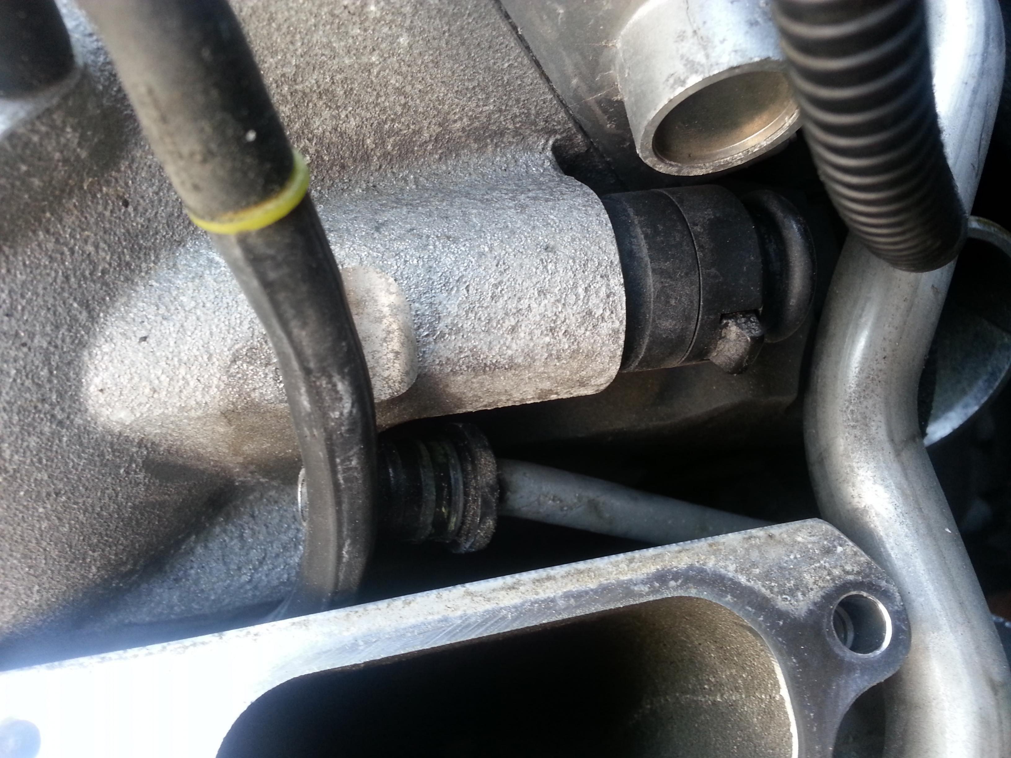

If you look towards the back right hand corner of the engine bay there are two lines, one braided line goes into your fuel rail and the other is a metal/rubber vaccum line which switches between a rubber hose and a metal one. You need to pop off your air boxes to track it further. The line bolts onto your valve cover gasket and then goes into a rubber grommet. Attached is a photo of the metal line in the rubber grommet, however the entire grommet is out in the photo. It is sittting ontop of where it needs to be pushed into. Look between your surge tanks and the supercharger in the top right corner. About an inch and a half down and about 2cm right of the throttle body is where it goes into. Ignore the two rubber hoses ontop of the supercharger the grommet is a couple inches below. Get a flash light and have a look down there. Ps no need to unbolt your surge tank to push it back in

Old Jul 2, 2014 | 08:11 PM
T9ja's Avatar
Joined: Jun 2014
Posts: 348
Likes: 10
From: Maryland
2005 E55 amg
Thanks. Will check on that as well.
