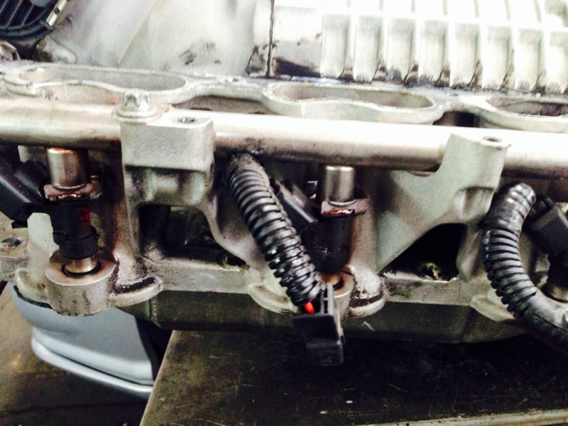

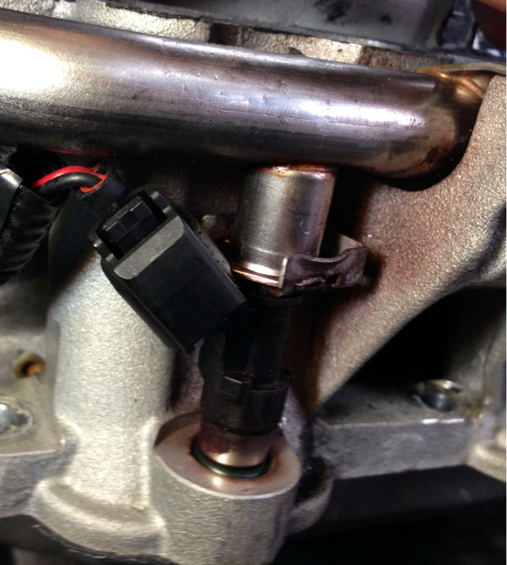

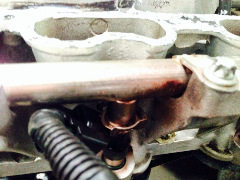

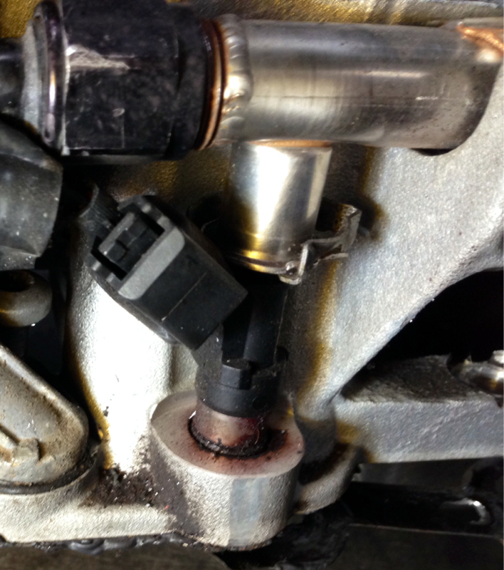

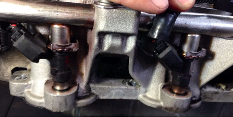

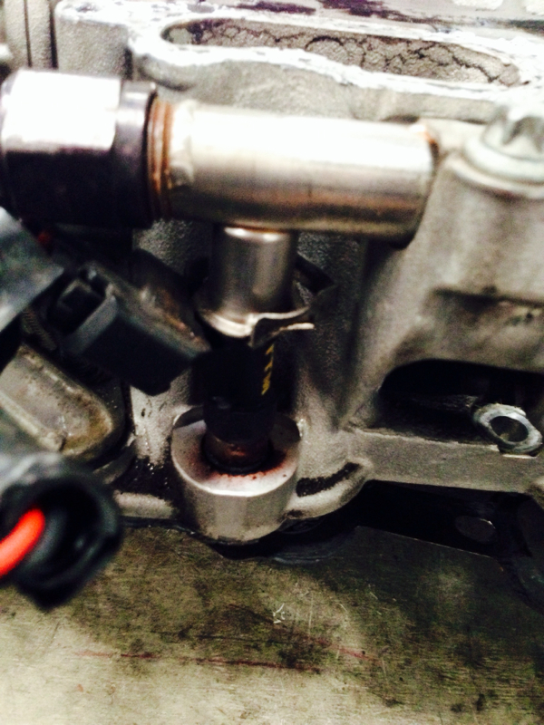

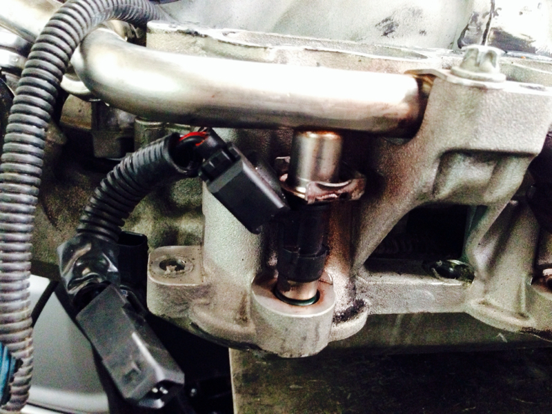

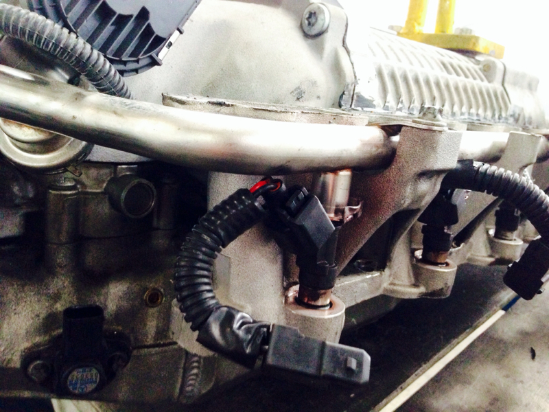

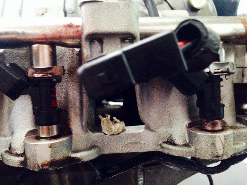

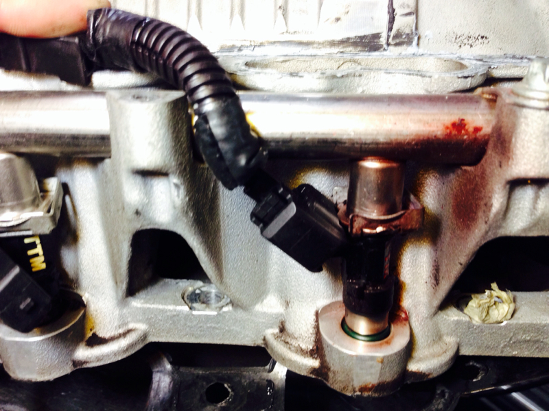

Dealer's head mechanic says the injectors are not all the way in and as you can see there is all kinds of residue outside of the injectors... The fuel rail is all the way down, and the hose that runs side to side of the fuel is fitted perfectly.
But there a lot of fuel residue, I don't see how these injectors can go all the way down.

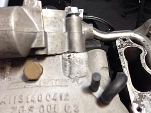

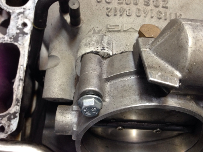

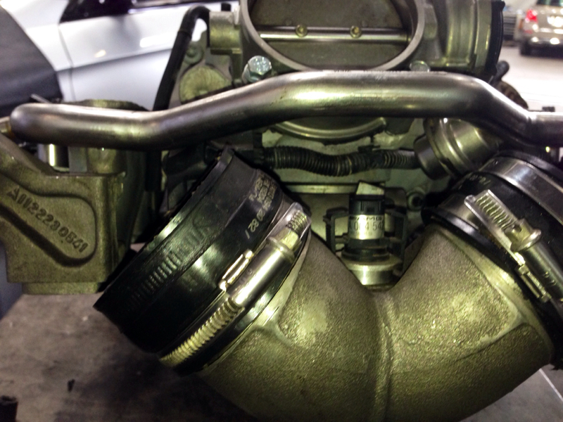

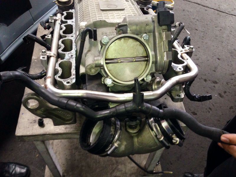

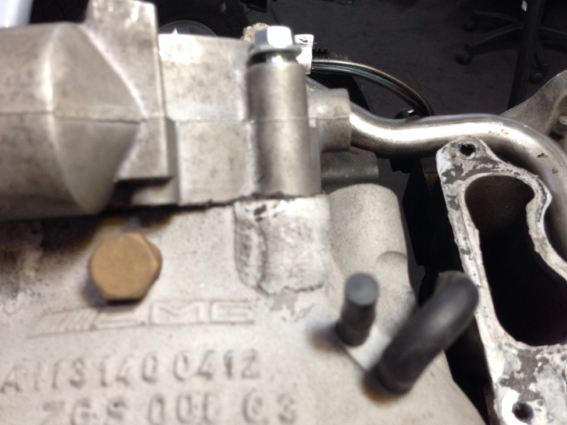

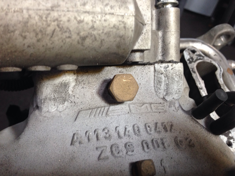

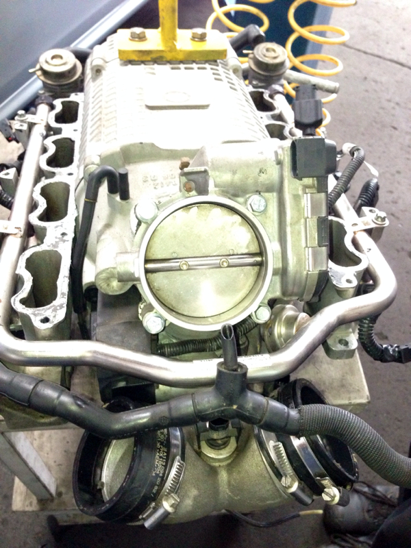

Also, there is this black rubber hose that in the original throttle body goes in and recirculates gases (or something along those lines...)
But on the 82 mm TB there is no way connect it, and it's just there, sitting, I don't that should be the case.
Also, please have a look at the work this TB base has, two screws are loose were to 82mm TB is tightened.

You're right, something doesn't look right with those injectors. Mine were a little dirty, but not that bad. I'm also running the TTM injectors. Maybe order some high quality injector O-rings and swap them out?
As for that hose, you can put an oil catch can on it, maybe?

My mechanic says he wants to put some "spacers" or something like that, which should seal the injectors and let them work properly, he does that on drag cars he builds, apparently, this seems to be a usual problem on drag cars.
Does that make sense?

Where the rail bolts down, there are these "tabs" that stick out. Maybe if those tabs were raised up a bit, it would push the injectors farther down when it is bolted down?

Those loose bolts may be bottomed out because they are to long, or maybe they are just loose. I blue locktite almost everything I take off for peace of mind.

Turns out my injectors were incorrectly installed, nobody at the dealer could tell what the difference was, it took SHARDUL a few looks at my pictures and he emailed me this "I know what the problem is with the injectors
The mechanic is using the wrong groove on the top to fasten the injectors to the fuel rail"
So, I told the dealer, and thats what it was... THANKS A LOT SHARDUL!!

it is a common mistake made during installation. The first grove from the top of the injector should be use to secure it to the fuel rail with the OEM metal clip. If a lower grove is used the injector will be too short.
