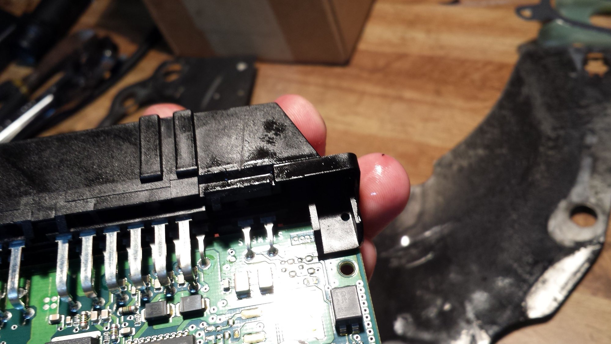

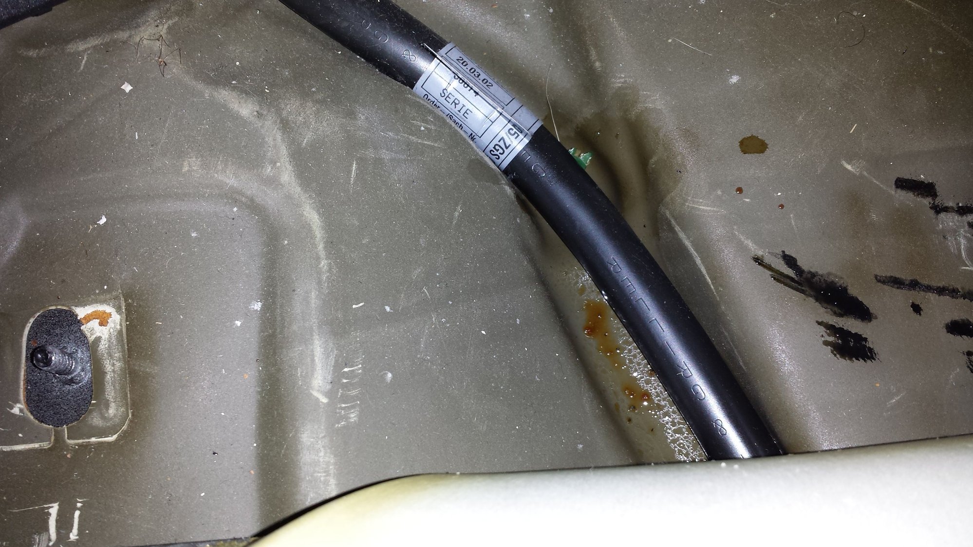

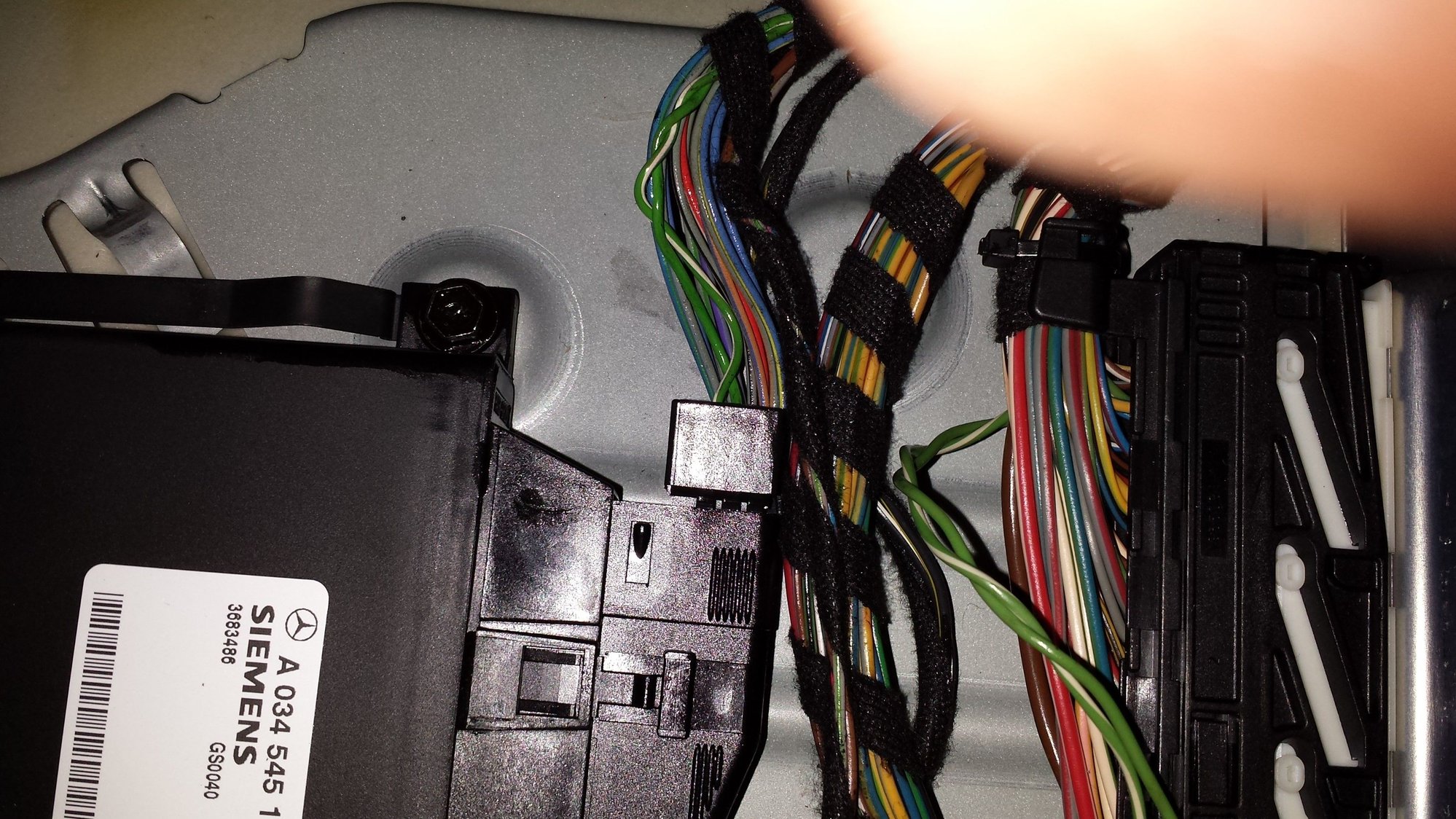

I pried it open last night and cleaned everything with electrical contact cleaner. Luckily there was only oil at the very edge of the board on the green part, nothing on any of the electrical interconnects. The oil made it mostly just through the harness and onto the male pins on the TCU. I am going to pick up the transmission plug soon and a new red tab for the filler so I can check the fluid level. Crossing my fingers this is the only issue and no permanent problems on the TCU.
Oil on the corner
after touching the wire loom
Just from touching the wire loom
Oil on the harness
ATF in the passenger footwell
small pool of oil on the bottom right black plastic. Luckily very minimal on the green board.
