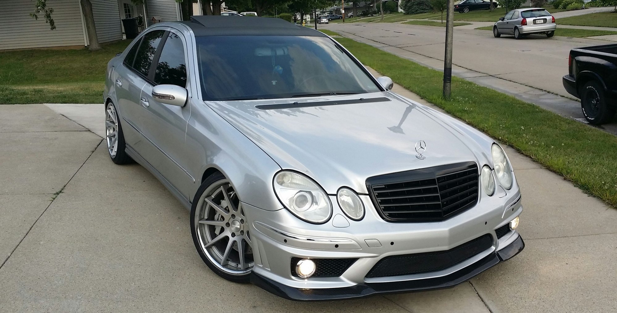

can you post a picture of your headlights?

Sorry if the picture is too big!

Those are NOT the updated (facelift) model headlights.
1.Did you try to reconnect your city lights?
2.Do you have an aftermarket HID kit for your High Beam?

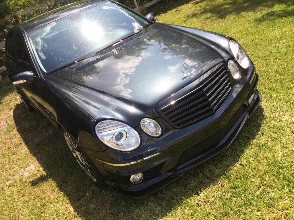

E55 W E63 bumper and lights
