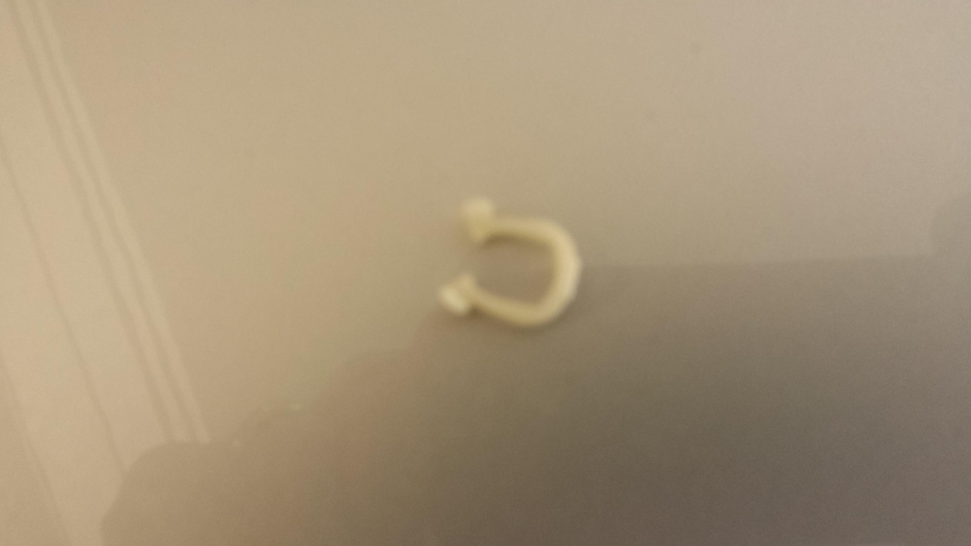

It looks like I am just out of gas. So my sending unit was not reading correctly.
can anyone tell me what the clip is for I found it in the bottom of the pass side gas tank.
thanks
Attached Thumbnails 1st e55 issue Help-2014-09-20-12.13.58.jpg   1st e55 issue Help-2014-09-20-12.14.11.jpg

If they are white , they hold the cables from driver to passenger assy.

Those clips hold the fuel lines into the pumps on the passenger side. If they are not in there then the fuel lines can pop off pumps causing a problem that closely resembles your concern.
The drivers side of the tank will empty first before passenger side.
You might have those clips if your fuel pumps were changed and some ******* left the old clips. But since you have it apart make sure the pumps have those clips where the lines connect

Does anyone have the part numbers for the little white c-clips pictured above? I seem to only have one when I removed my old sender yesterday.
