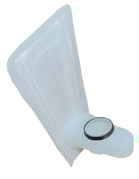

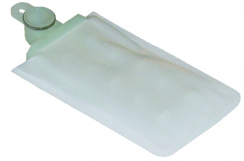

ok just to help out here.
Inline filter is probably a waste of time and the flow restriction is not from the main filter.
Its the pre filters that burn the pumps out, so will be replacing both the pre filters on the pump. I want to use the largest possible to increase the flow.
Attached Thumbnails Inline fuel filter-22-016.jpg   Inline fuel filter-22-142a.jpg   Inline fuel filter-img_20130616_150854_847_zpsc480667a.jpg

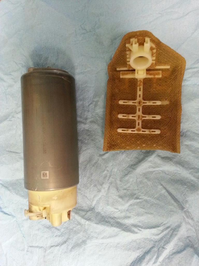

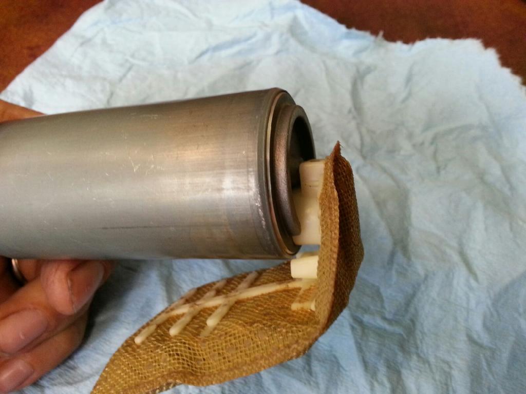

thanks,
done that twice already on the car and had a new filter installed both times. That filter is after the pumps and its not really a restriction problem, its the 2 pre-filters on the dual pumps that clog up and cause failure.

That pre-filter is not dirty, discolored yes but dirty enough to impede flow, no.
I have taken quite a few fuel pumps out and the filters always looks like that after a few 100 miles. No big deal and won't impede flow.
The secondary filters however.....
