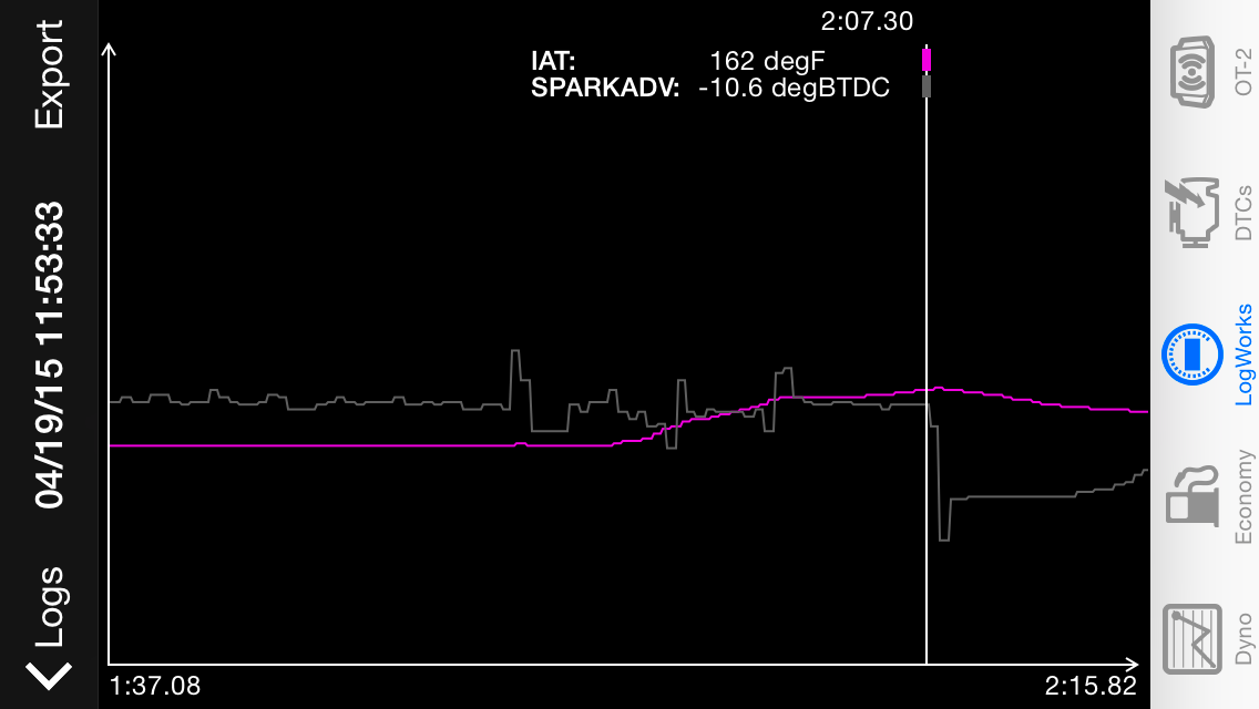

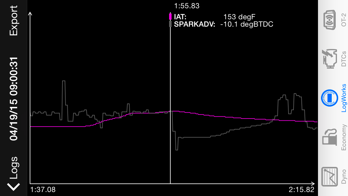

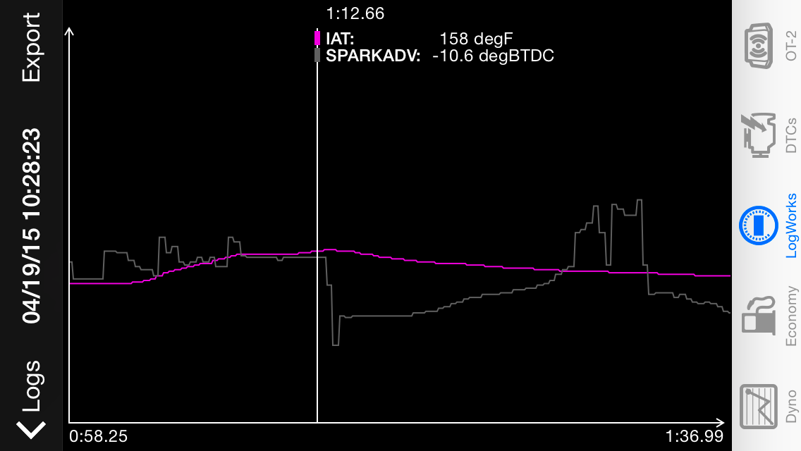

got some graphs
I managed to get logging for three runs today.
First run
This run was a 12.03 when the DA was -121ft and the ambient temp was 54 deg.
Second run
This run was a 12.09 when the DA was 170ft and the ambient temp was 58 deg.
Third run
This run was a 12.16 when the DA was 454ft and the ambient temp was 62 deg.
Any thoughts on these graphs? The car was actually quite predictable today. It was fast in the morning, and slower but consistent when the weather warmed up.

Your car is pulling major timing since your iats are over 120*
