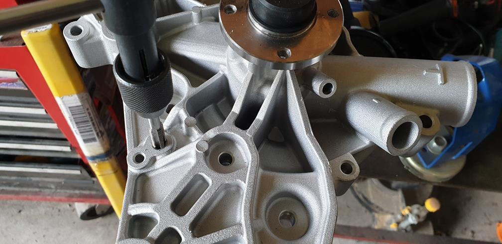

On my m113k 4matic swap I have a block off plate on the bypass valve and a clutch less pulley. 72mm. Worked out great. Just a heads up on putting the supercharger on a m113. U need to swap the timing cover over from the m113k. The area that holds ur secondary air pump will interfere with the supercharger snout. Also u won't have the super charger tensioner bracket which is part of the water pump. Idk if u can just swap over a water pump.

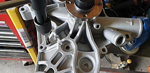

When you get an aftermarket replacement water pump for an M113K, you really get one for a M113. You may need to tap one or two holes for the supercharger tensioner mounting. I have done this exact thing without issue.

Quote: On my m113k 4matic swap I have a block off plate on the bypass valve and a clutch less pulley. 72mm. Worked out great. Just a heads up on putting the supercharger on a m113. U need to swap the timing cover over from the m113k. The area that holds ur secondary air pump will interfere with the supercharger snout. Also u won't have the super charger tensioner bracket which is part of the water pump. Idk if u can just swap over a water pump.
its “unprofessional” but the timing cover can be cut to make room for the supercharger snout
otherwise the water pump should have all of the mounting points necessary for the idler and blower tensioner
