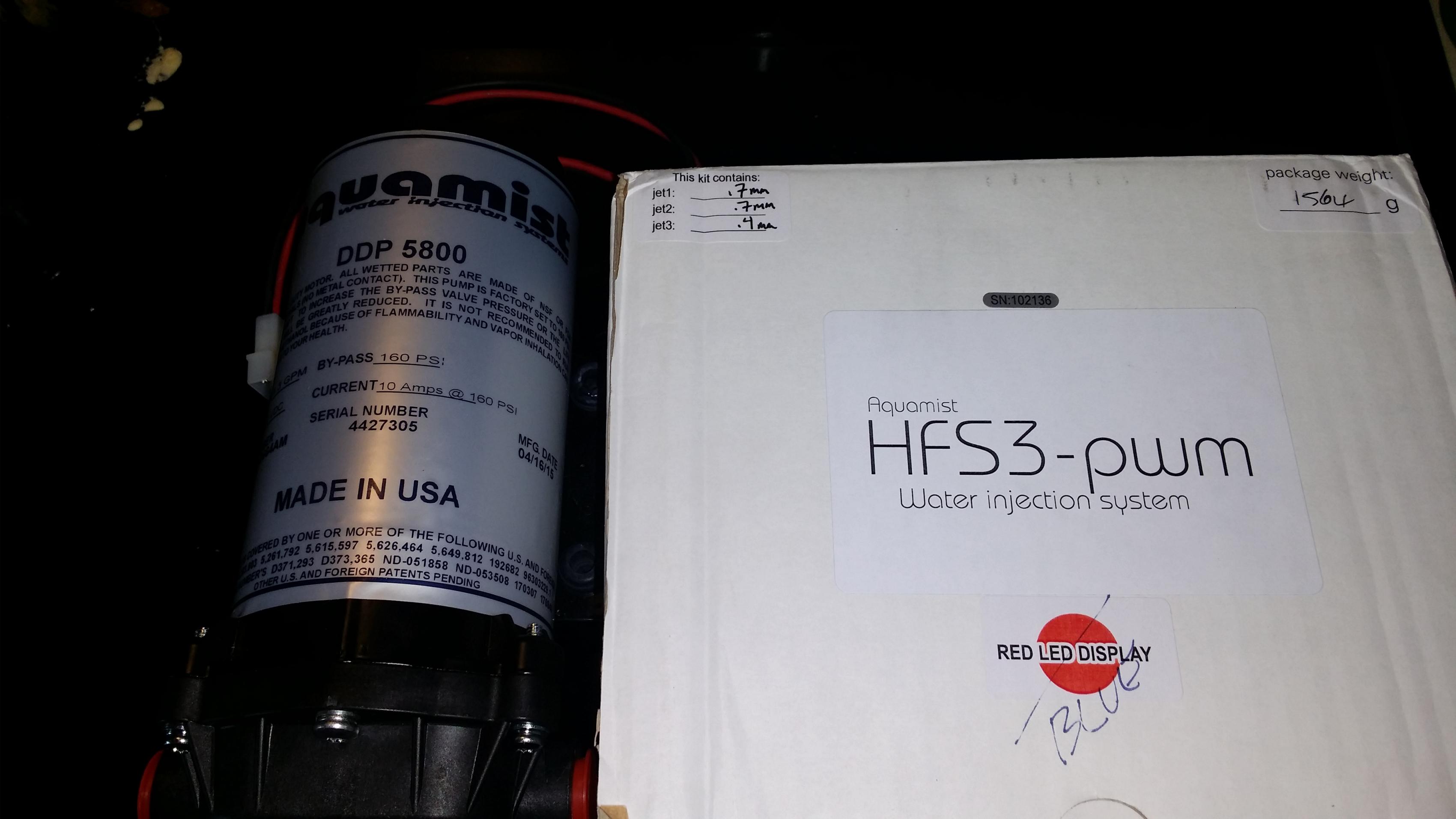

Just received mine in the mail Friday, only going to use one of the three listed.

Jmb, .7mm post ic

.7mm is roughly 300cc according to this: http://howertonengineering.com/tech-...ating-jetting/

More is not better in this case, I had a bigger nozzle and it was making the tune very rich, I ended up turning the meth off because it was useless. Actually made the car lose power. Went to the smaller nozzle and happy now

I tried to go much larger, same as you, until Hulk advised otherwise based on his personal experience. This way the worst that can happen is that I spend another couple hours pulling the blower off to swap jets.

Jmb, 50-50, when I tried water exclusively it would run pretty bad also, almost like extinguishing the spark. Had no choice but to run smaller, I am happy with the .7mm from aquamist
Also note that that chart is at 160psi for the pump. Usually the pump comes preset at 200psi so it's a little more than the ~360cc shown on that graph.
Of course this only applies to those using the aquamist system as well.
The AQ nozzles are top quality
