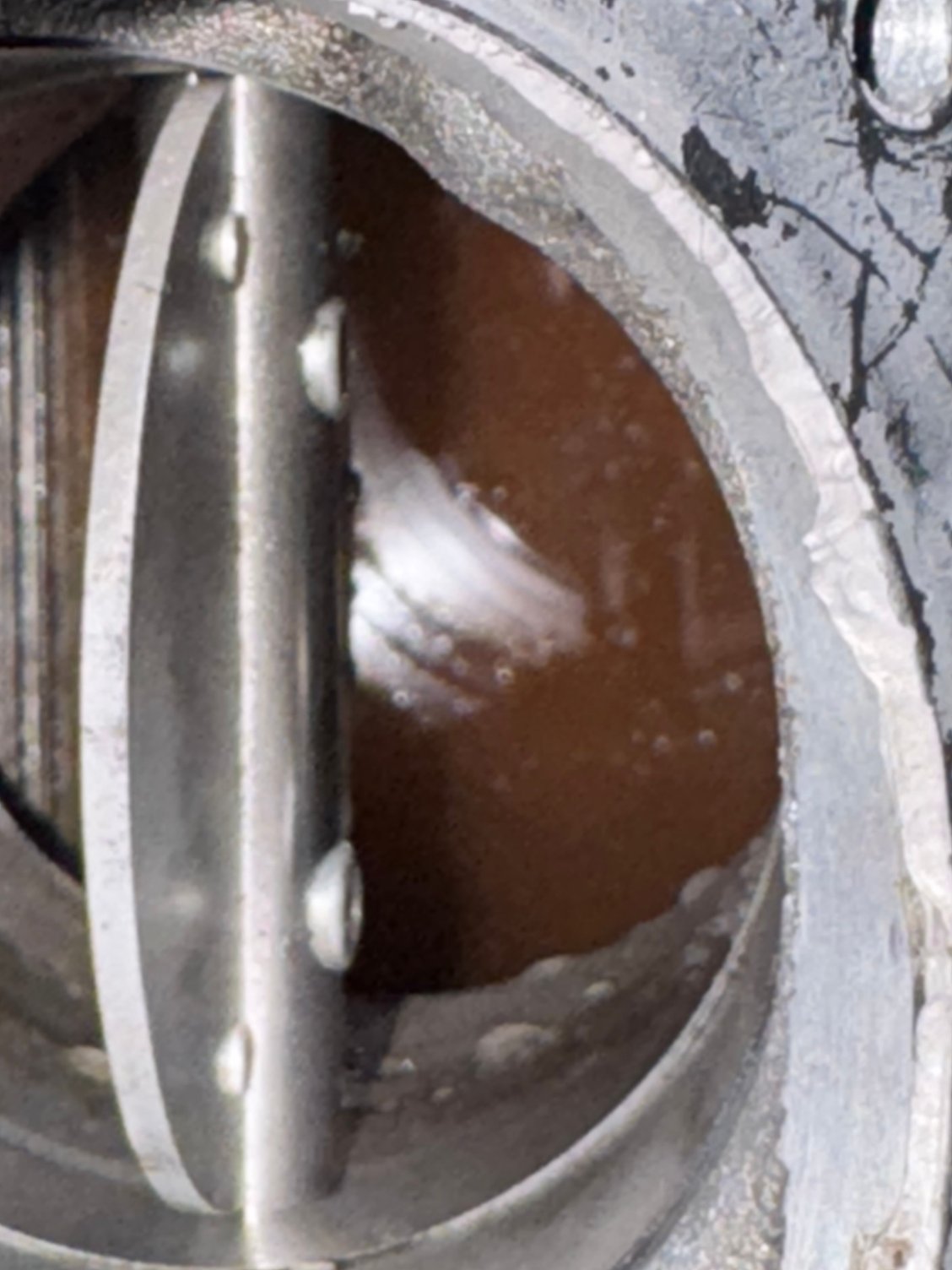

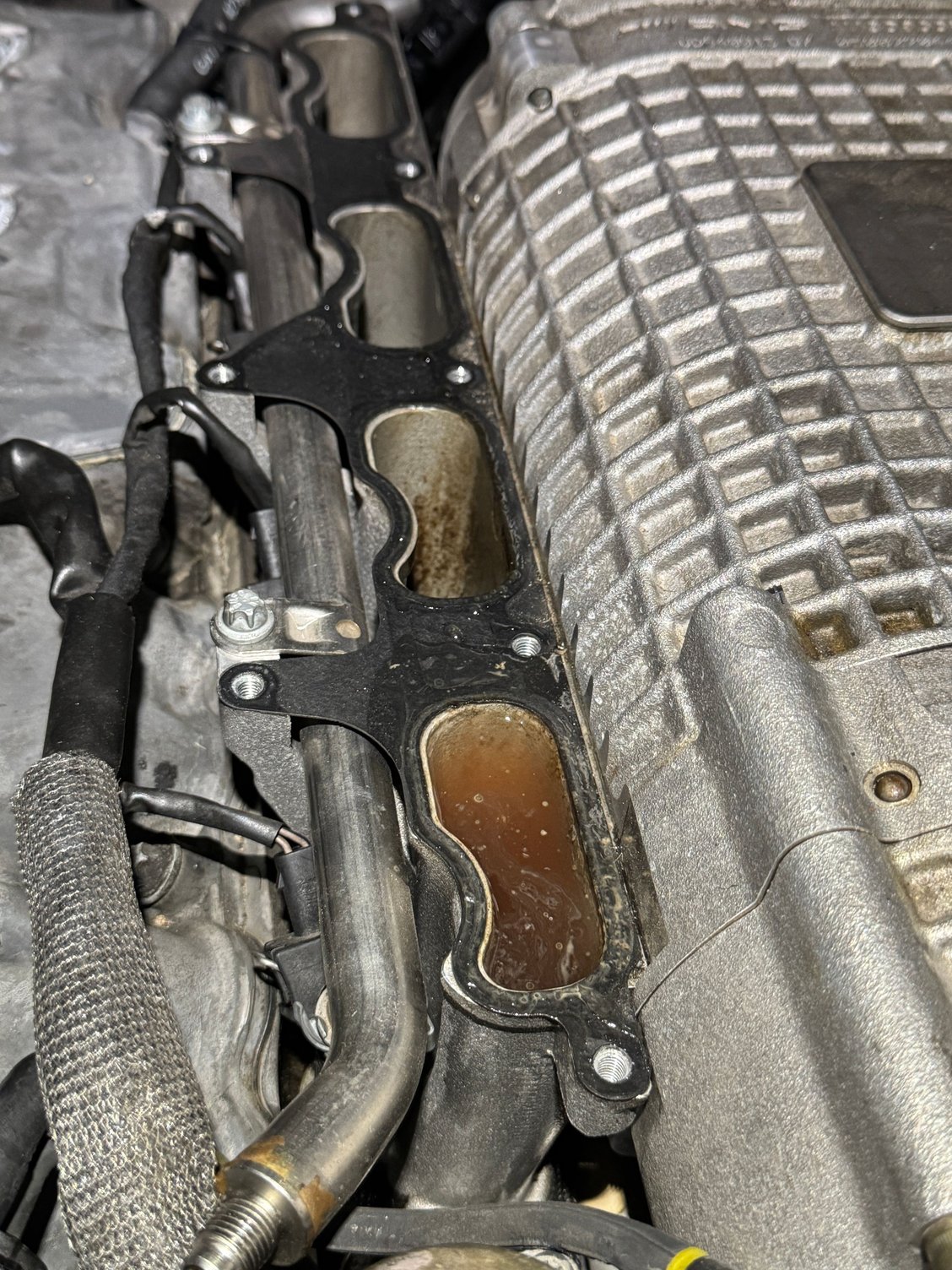

Just troubleshot though a cracked intercooler core in the charge cooler. Found coolant in my bypass under the throttle body when I had the rail apart for a fuel pressure damper.
Finding the coolant explained a lot. I had a leak when it was running; but boost kept it from being a problem. It would seal the leak and at WOT I would get coolant pushing out of the split cooling reservoir. I always had a very random coolant loss from it being consumed and going into the bores and then it going out through the cooling tank lid.

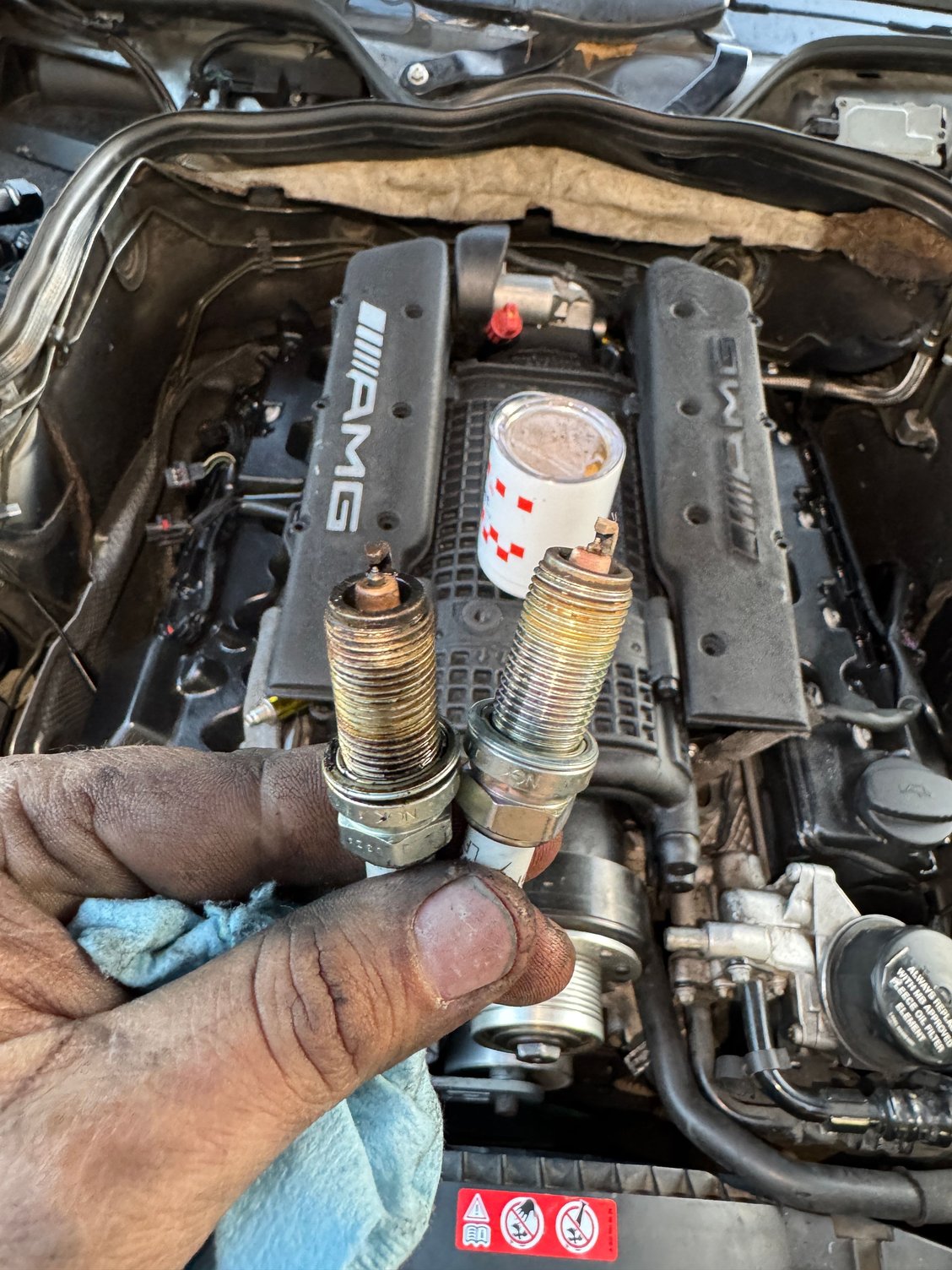

I had constant rear cylinders that would come and go very inconsistently. I did so much chasing them, but I found the coolant and it explained it all. The plugs were covered in my residue of water wetter. Thankfully carb cleaner took it right off.
Just documenting this for the sake of all mankind.
When I would run the pump switched on, engine off it would seep coolant into the cylinders. It nearly hydrolocked while trying to restart after a long period of starscan time. I should have wired the pump to a switch.
