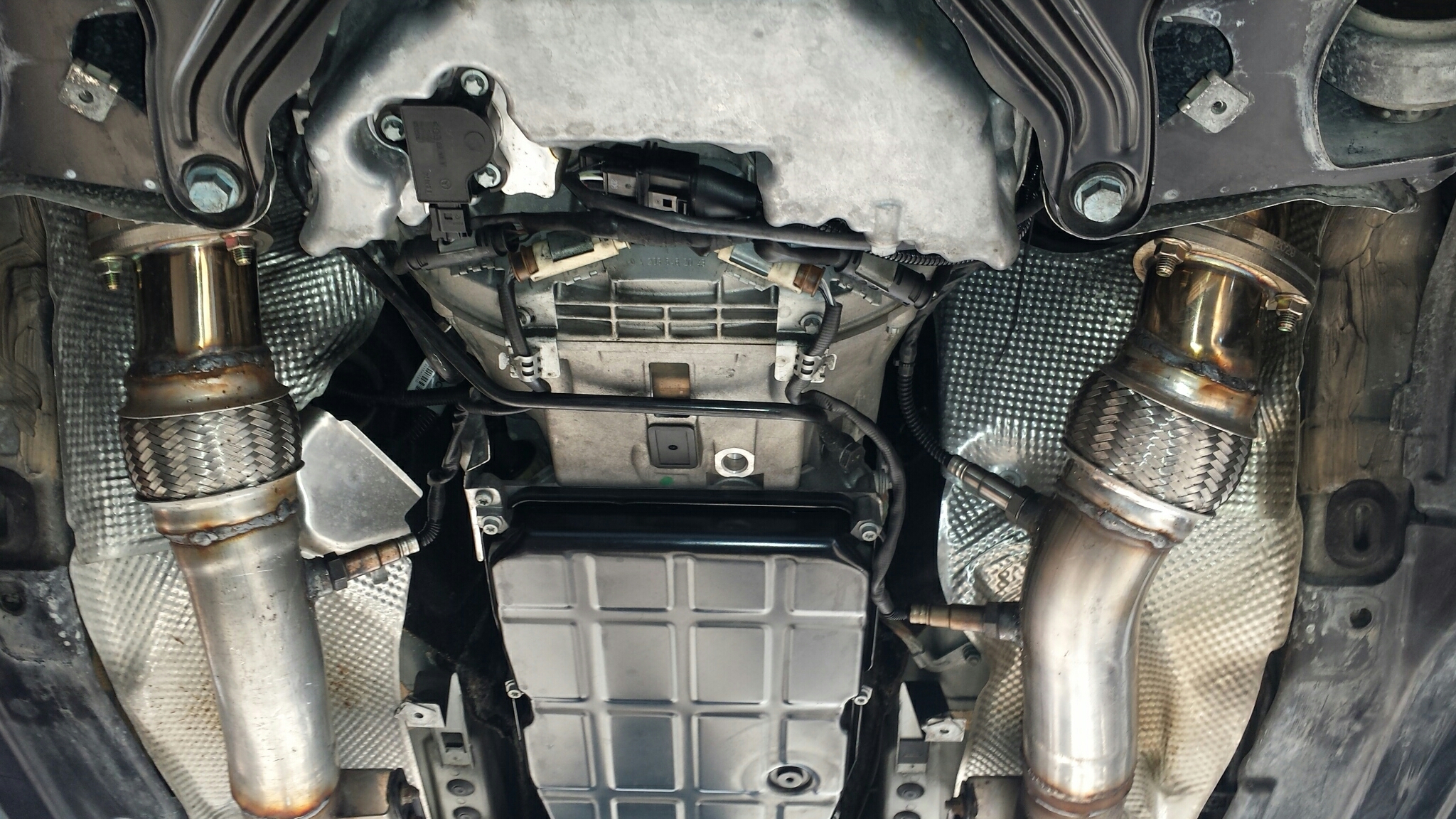

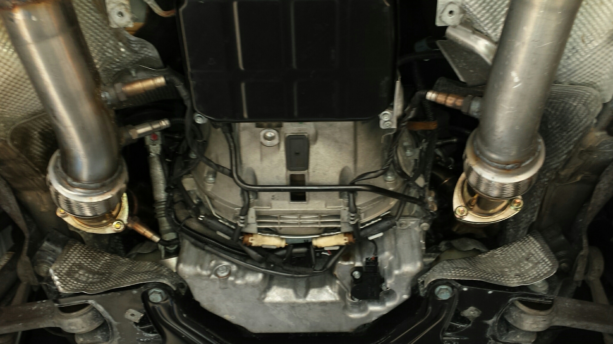

Exhaust done today. The 3" flex pipe was a nice/needed addition to the fab work. The down pipes off of the EC headers required considerable cutting down for everything to fit and flow correctly. Car sounds very nice with secondary cats and reso's in place. Deeper growl but still passes off as "not modded" sound wise! Air fuel is definitely on the lean side. Car is not tuned yet so one very, very quick 3rd gear pull at boost netted 13.2 afr. Couldn't monitor a/f prior to exhaust mods. Will get the tune installed this week if time permits. Car feels better with new motor mounts as well. They probably kept the car in one piece while driving to the shop open header. The resonating may have loosened half the interior bolts on the way over this morning at 530am.
