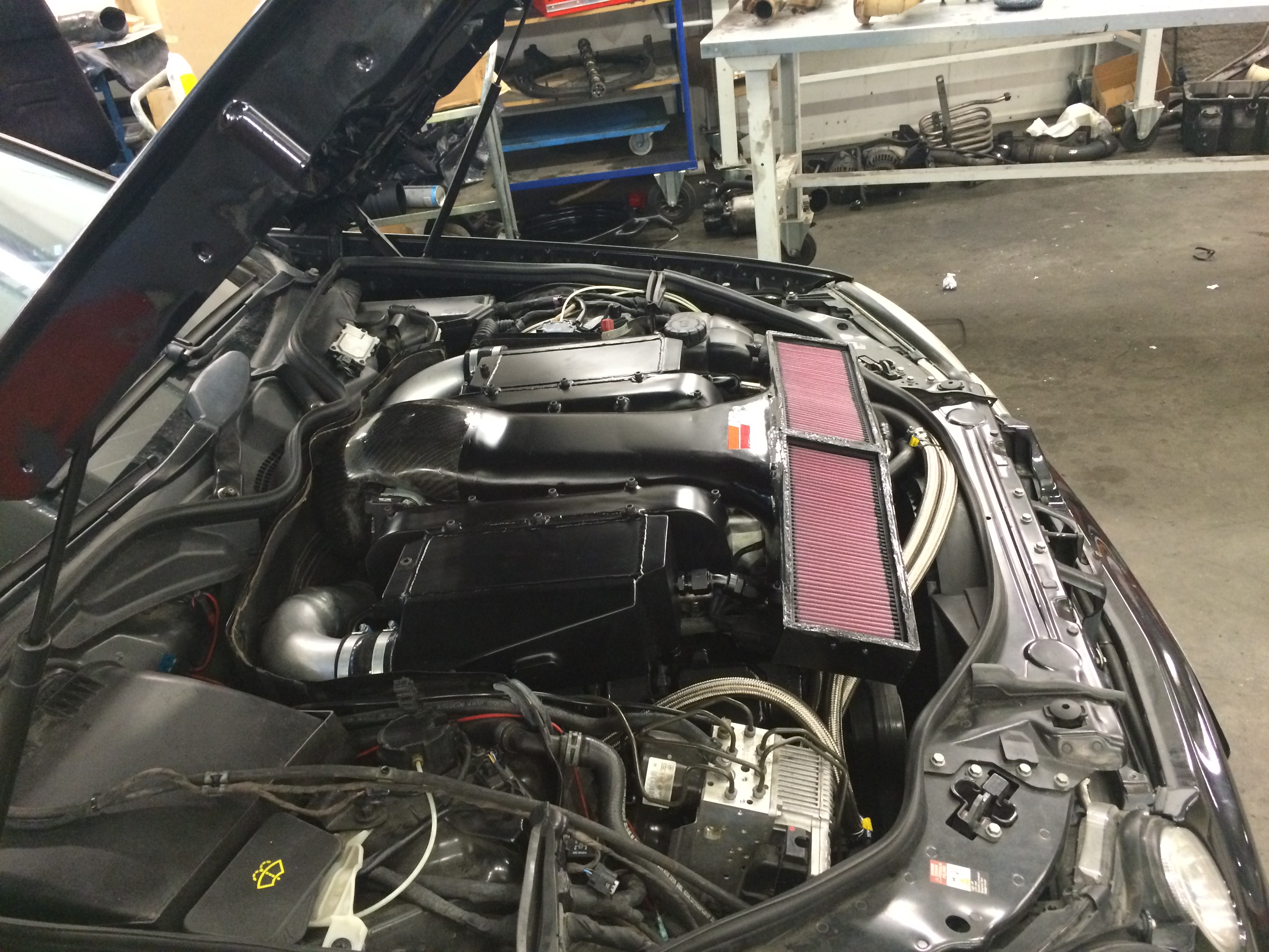

[QUOTE=crazyman;6715394]Its not steady at all...lol I have my stock intercooler deleted and 2 topmounted intercoolers.My boostpressure is a bit higher than with stock intercooler,about 17-18 psi,if i read the boostgauge right while smoking the tires like crazy at high speed anyway...my fuelpressure dropped to about 61 psi under full load,and thats not soo good!61-18=43psi.Havent measured AFR yet,still
Pics of intercooler please

Thats how its gonna be,and then ram air intake

Looks awesome!!
Are you going to modify the hood? Looks like it could suck in air from under the front windshield, but then you'd have a really small airfilter

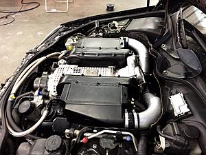

I modified the hood bigtime!lol the only way out with Twin big intercoolers...

That intercooler system looks great! Not to get off topic but do you have anymore information in it?
