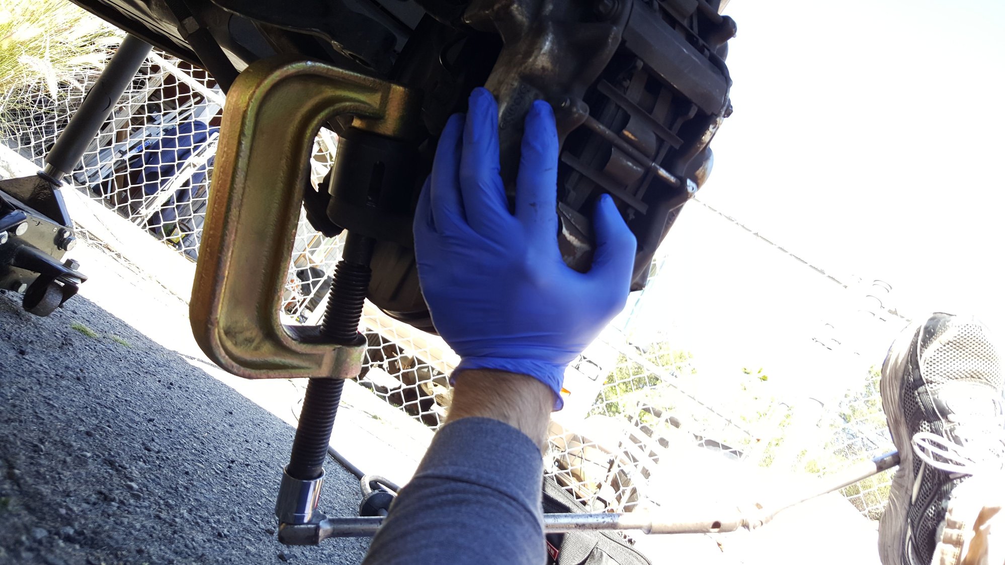

Post an example of you thinking outside the box to tackle a problem on these cars.
Steering kept turning so got creative and foot power!
