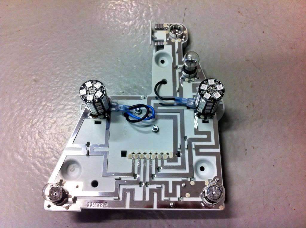

What I meant was there's no simple plug and play solution because the stock bulbs are soldered to the assembly. What you have to do (and this will be true for every bulb be it LED or standard halogen) is de-solder the bulb that's currently permanently fixed in the housing. Once you remove it, then you can plug in a new bulb.
You'll want to confirm though that the bulb used for reverse is a 194/T10 though. As it was designed to be replaced as a total assembly as opposed to bulb by bulb, the replacement bulb specs are not listed anywhere. If you remove the stock bulb though and shoot us pics, we can identify what kind of bulb it is.

been wanting to do this, but haven't wanted to desolder and add resistors to the factory tail lights. the socket size compared to bulb size isn't standard as well if i recall correctly. you can fit another bulb though, but will require you soldering in a accepting socket or wire directly to bulb.

Here are some pics from GunMoto's thread https://mbworld.org/forums/w211-amg/...ml#post5804159

whoa... someone could make a good business converting those over to LED

i did this tree years ago so i dont remember exactly what it looked like,i Think it was a 4000K xenon of some sort,doesent matter as you have to cut away the plastic around the bulb itself and glue it in Place in the original bulb holder in the car. I am very happy with the result looks like high beam in reverse! no codes.
