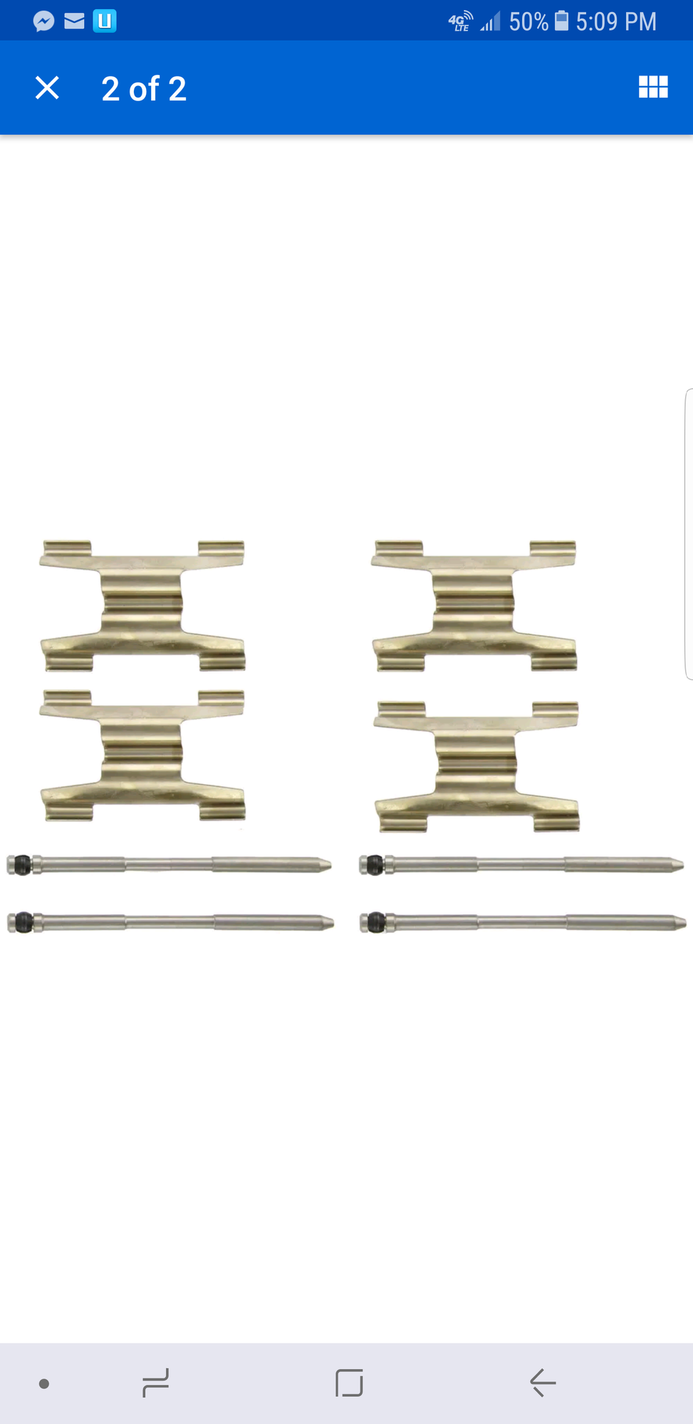

Oct 7, 2017 | 05:11 PM
Do replacement pads come with this new hardware?
Do replacement pads come with this new hardware? I'm looking at the Akebono pads.
Reply 0
Oct 9, 2017 | 02:40 PM
Quote: Do replacement pads come with this new hardware? I'm looking at the Akebono pads.
Not in my box.
