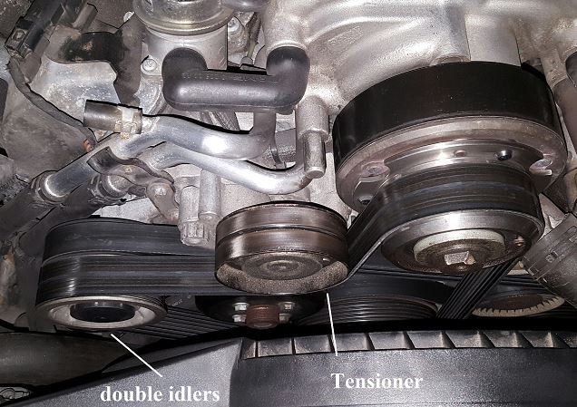

Anyone can help me out with a picture of our engine Pulleys
2 of my pulleys need replaced but I cant find out part number am a moron to look WIS / EPC sometimes specially now..
The 2 pulleys to the left of the supercharger barrings is time as I noticed slack in them then when checking the Pulley Belt. Only cant find out part number hope we have a friendly soul that can help me out here...
Thanks guys you always so extremely helpful, higly appreciated.

If you're talking about the double ider there is a thread about rebuilding it. I don't have the bearing # for the metal one, but the plastic pulley is Dayco 89130.

My father had their parts department at work purchase the Nachi bearings for me. I replaced the supercharger bearing, the double idlers, and the tensioner. I'll get you the part number when I get home later today!
Thanks a lot appriciate it,, already did did the SuperCharger with Nachi bearing but didnt know this also works for the Tensioner and Double Idlers, hell even used the oven / freezer method worked like a charm lol did it in my wifes kitchen
You both are GODS thanks a lot.. poblem is I am not sure what is what haha that was my original question but when I look at it and think about it hmm ofcourse tensioner is the one left to the SuperCharger also used to release the Supercharger belt, double idlers left and down from the tensioner,, right..
Double idlers / Tensioner
