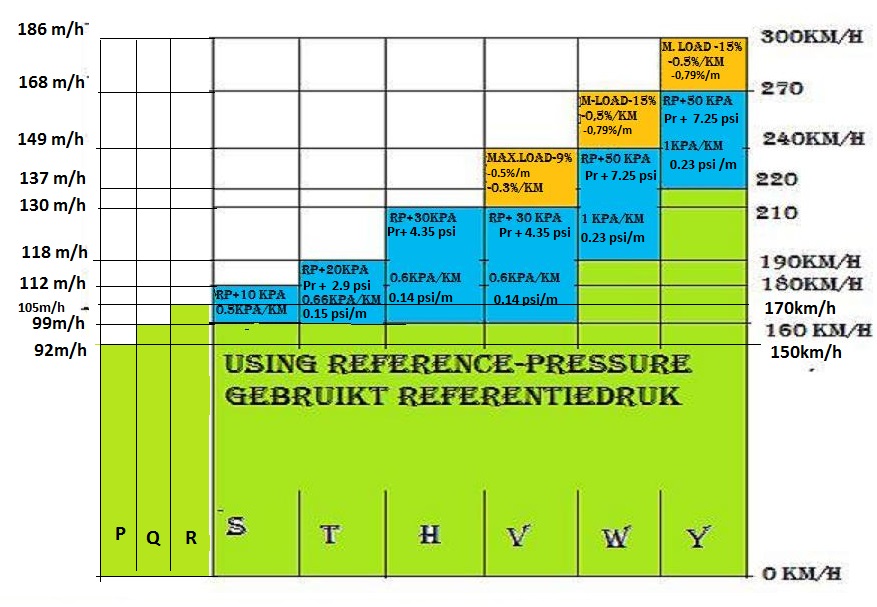

If you want comfort , gripp, and savety , you can use the pressure up to 100m/h, and probably ride that over 100m/h once a while, when you are alone in car and a little load.
Then when you have incidental higher load , you must realise that you must not drive that fast.
So for every speed and load on tires , I can calculate a pressure range.
So a highest pressure with still acceptable comfort and gripp, and a lowest pressure for the speed you wont go over for even a minute, at wich no damage to tire.
That speed thing also works the other way , so lower speed , more deflection allowed, so lower pressure for the same load , or higher loadcapacity for the same load.
So one pressure can be yust fine for your normal use, but for lower speed it can be fine for fully loaded .
Roughly you can add 1 Loaindex-step for every 10km/6,5m lower speed then 160km/100m/h, and the other way around 10km higher speed is 1 LI-step lower maximum load.
The maximum load of a tire is calculated for the reference-pressure ( Standard load P-tire 35 psi) and reference speed of 160km/99m/h, this up to V-speedrated tires.
Will give a picture I made of the official system used , once got hold of the European formula with the extra's for speed and camber-angle.
My idea is to replace that official system, wich is for every speedrating different, by my simpler system of adding or substacting the loadindex for speed.
Attached Thumbnails Tire pressure for over 100 mph-referencepressureptoy.jpg

Wow, I'm impressed by the work you've put into this. Still, you make me believe I need to add a few PSI above 35 for my V rated tires because of my rare jaunts into the triple digits.
