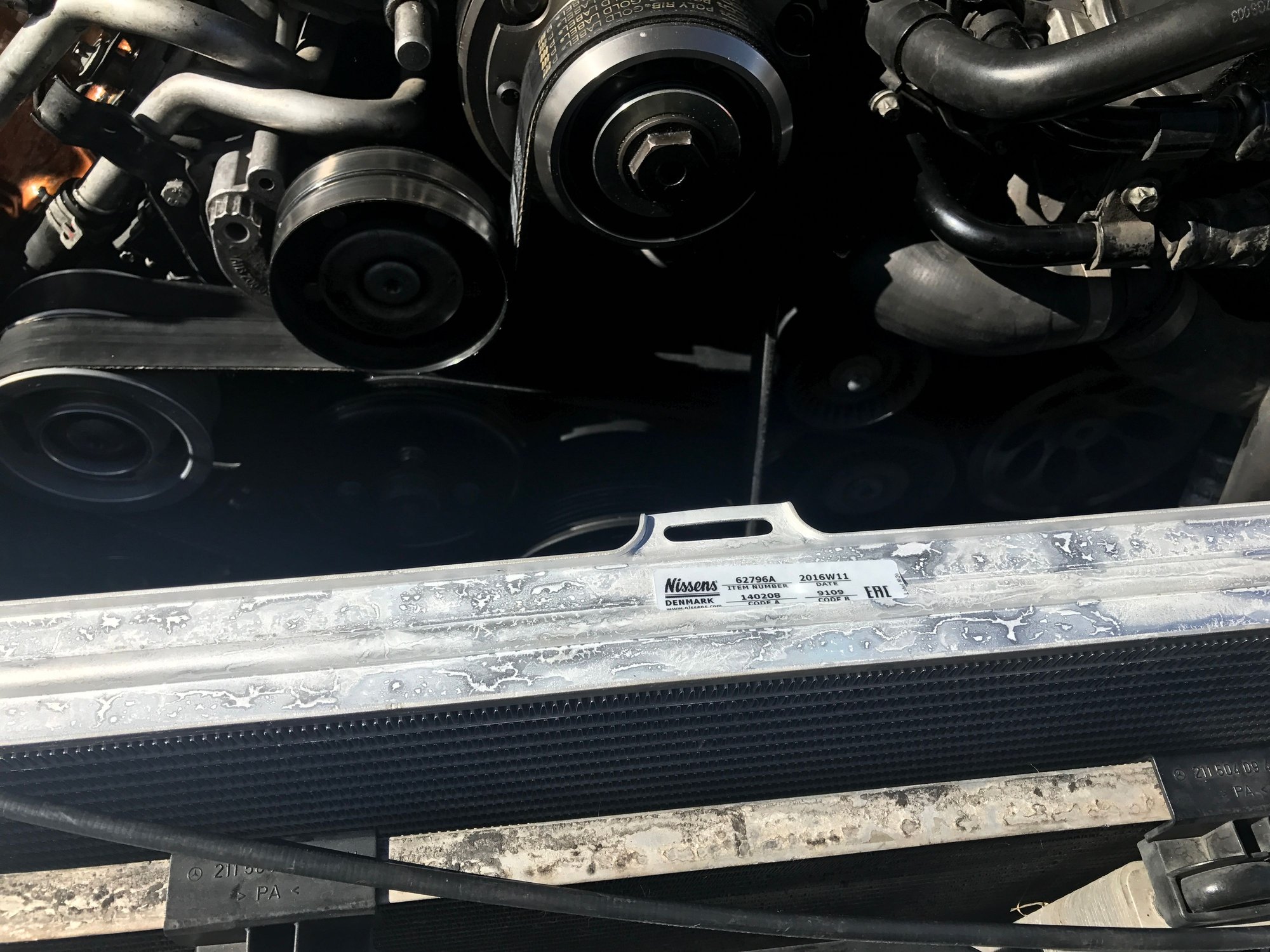

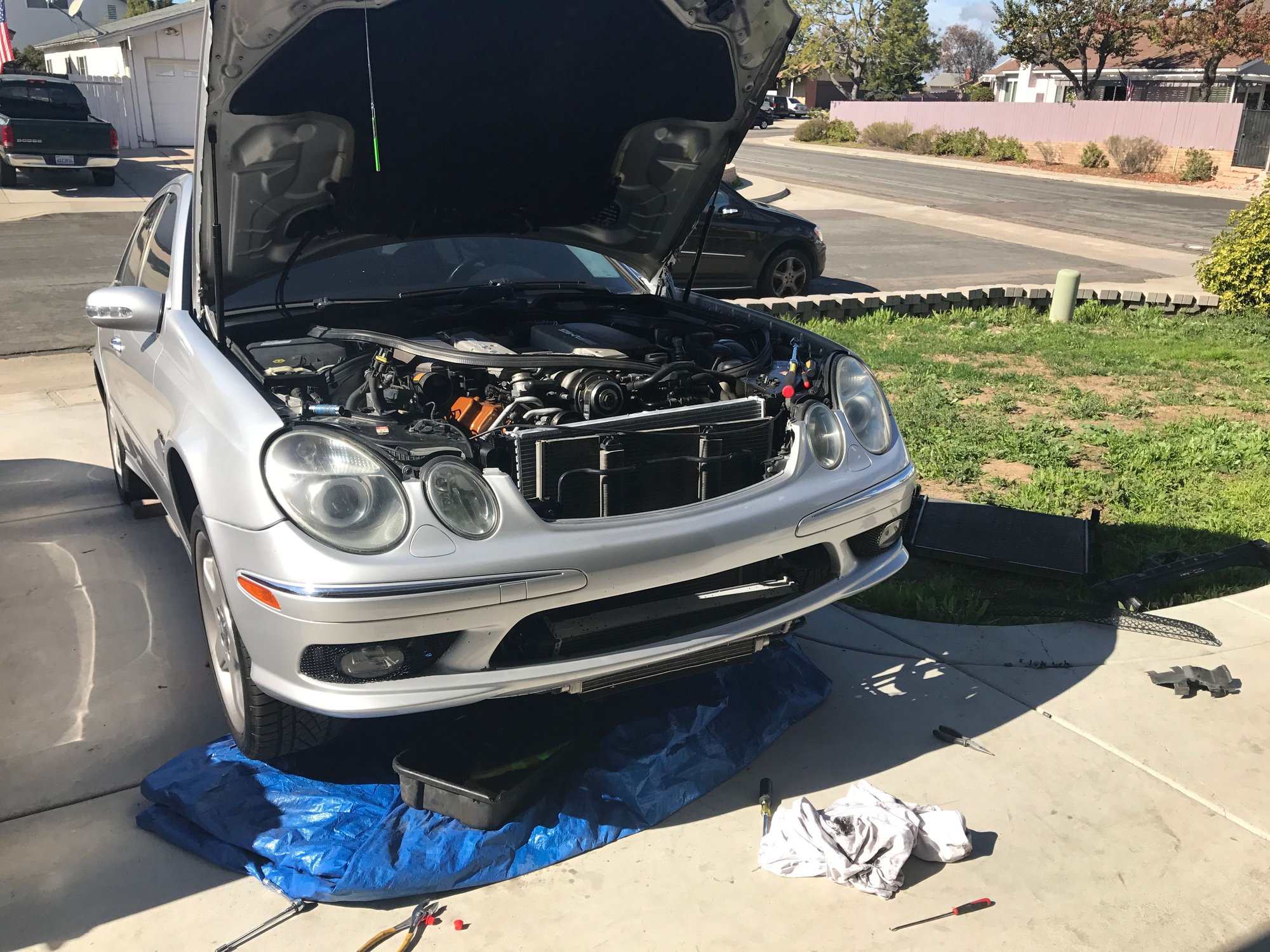

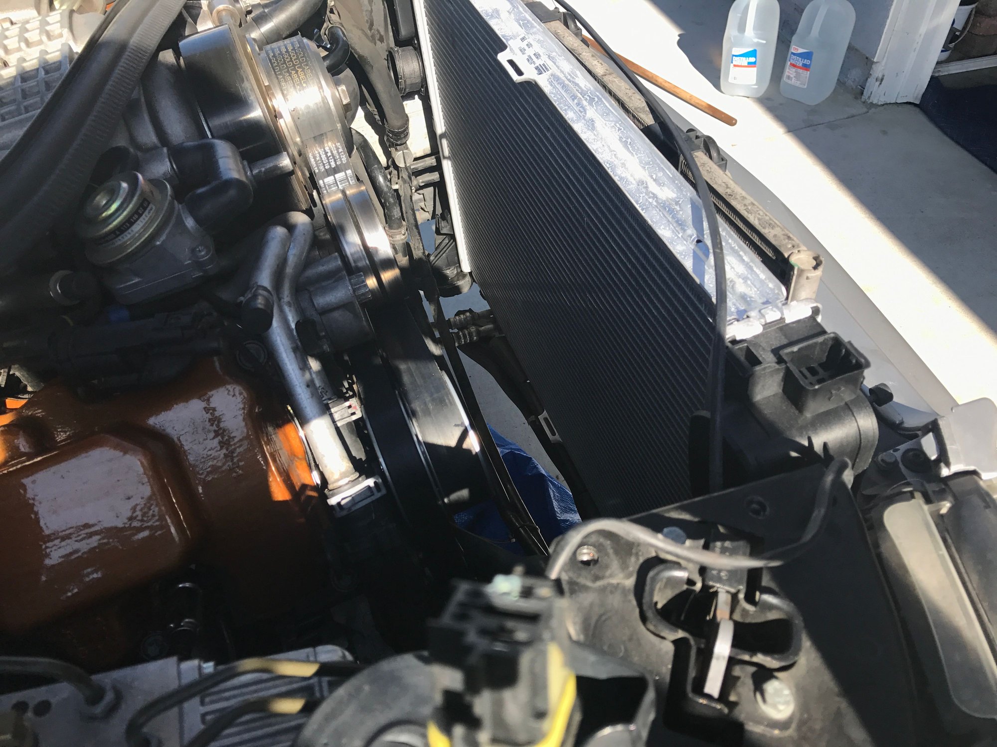

W211 E55 Radiator DIY Complete
Thanks for the resources, I was able to do it in 4 hours this weekend including a little cleaning. All in all it was pretty straight forward, just go slow and make sure you unclip everything as you pull the radiator out. I followed the instructions in the video below with the exception that it's for a e320 so there were some additional steps to separate the Heat exchanger from the Radiator (undo the hoses that run into the HE on the passenger sode of the HE. Pictures below, thanks! Oh and I went with a Nissen replacement, fit perfectly without any issues. Old one was a Valeo manufactured in 12/04. It was leaking at the seams and into the driver side intake inlet.
