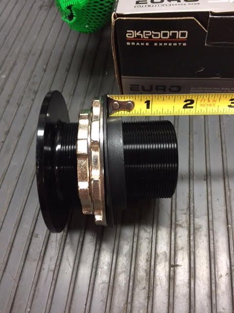

Measurement Confirmation
Originally Posted by BoostedAero
I had a hard time finding info on a good "start from here mark" and chose the 1.5" from max mark
Since a picture's worth a thousand words...
... is this the measurement you were referencing? It's hard to tell from the angle of the photo, but the distance from the bottom of the threads to the plastic surface where the spring mounts is almost exactly 1.5", as set from the BC Racing factory. Both mounts are adjusted and locked at the exact same position, so maybe they took your advice?
Old Mar 15, 2017 | 02:42 PM
BoostedAero's Avatar
Joined: Jan 2016
Posts: 599
Likes: 120
2004 E55
Yes that is it exactly, I don't think I measured the plastic piece though. You are basically right there. Sorry for the delay, bet you have those suckers slapped on already
