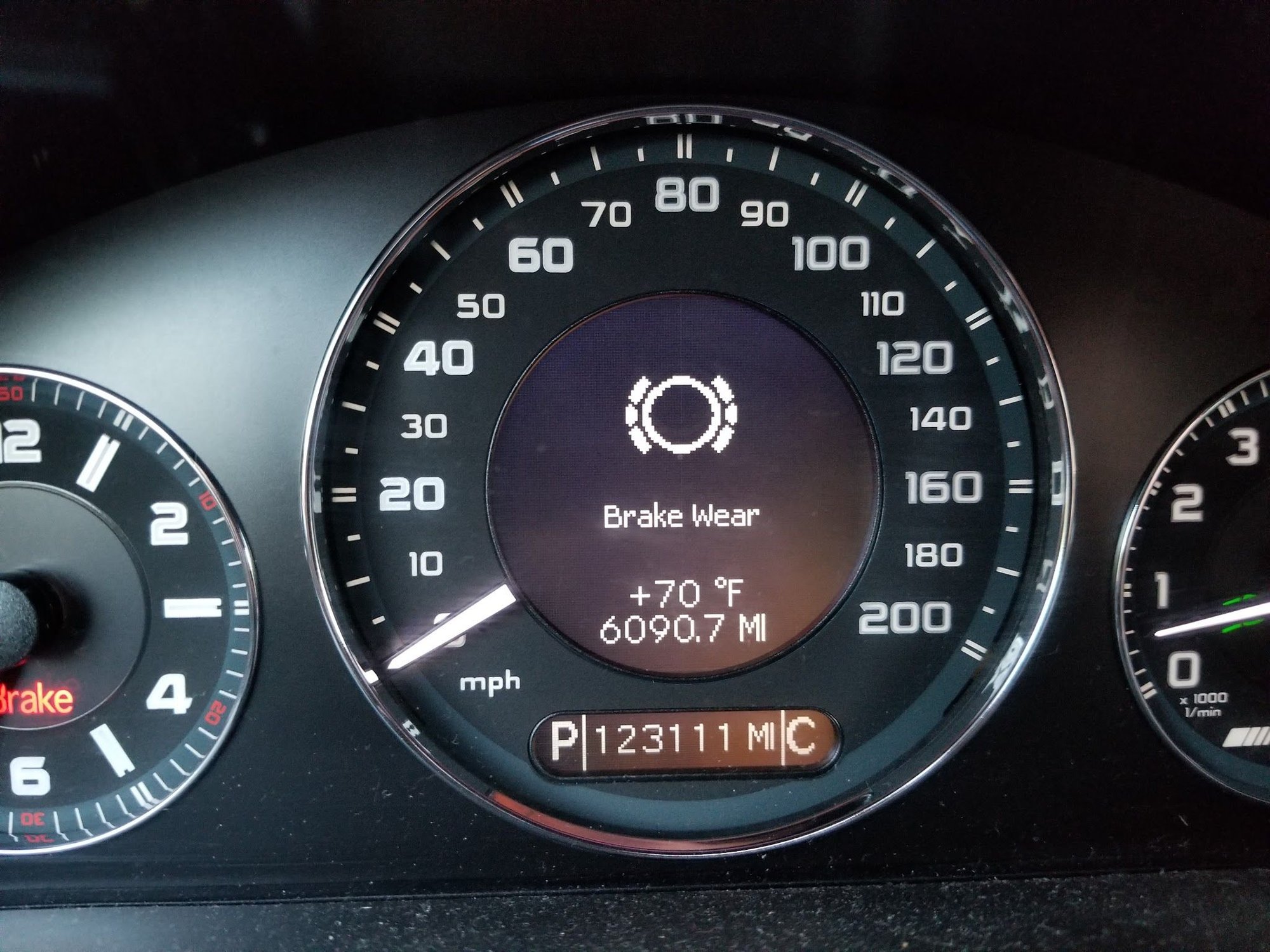

When I bought my car it came with a full service history. It helped sell me on the car. All oil changes where documented and all other service and no mention of brake replacement. Seeing how the rotors and the pads are both done im just curious how well these brakes did compared to everyone else, I took this picture when the light came on

brake pads last like 20-30k miles from what I've seen with my own car. rotors last longer. i wouldn't replace the rotors until the slotting's are getting low. last job I replaced the pads with Racing Brake XT910's
to note...when you only replace pads and not rotors on Europeans, you do run into the possibility of having noisy brakes.

At 123K miles, if the front rotor has not been changed before, it absolutely needs it now. 1.3" is minimum thickness. They start at 1.4" new.
