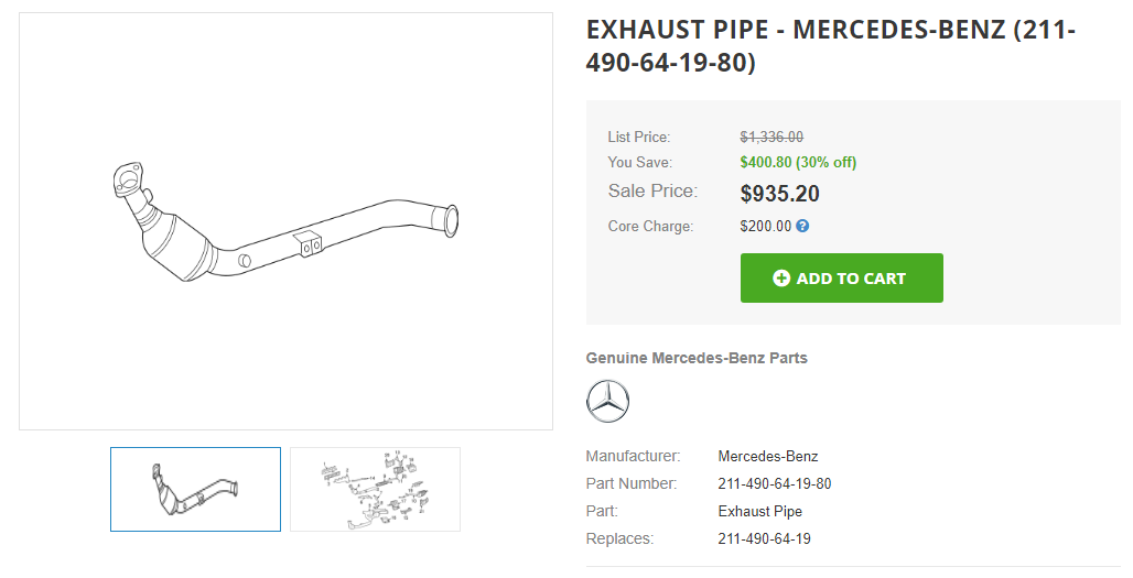

E63 parts

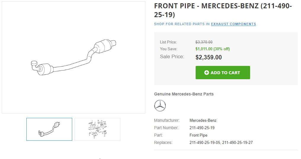

E55 Parts

the drawing for the E55 is wrong - this is the exhaust setup on the E55

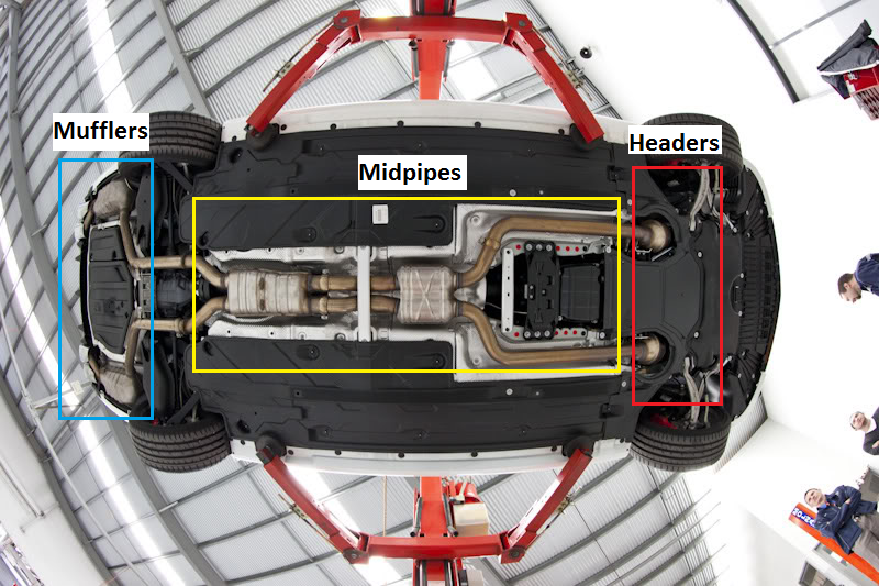

I believe this is the E63 (6.3) exhaust - can someone verify?

seems like the systems are very different visually from the pics above - can you look under your car to see if you have the secondaries bunched up like this?
or is is a wider split system?

the picture posted is incorrect. the W211 E63 looks the same as the E55's, but the piping might not be the same size? i feel the E63 has bigger piping there.
I think the E63 pic I posted is a newer w212 model
Pretty sure it is since the underside of mine looks nothing like that.
