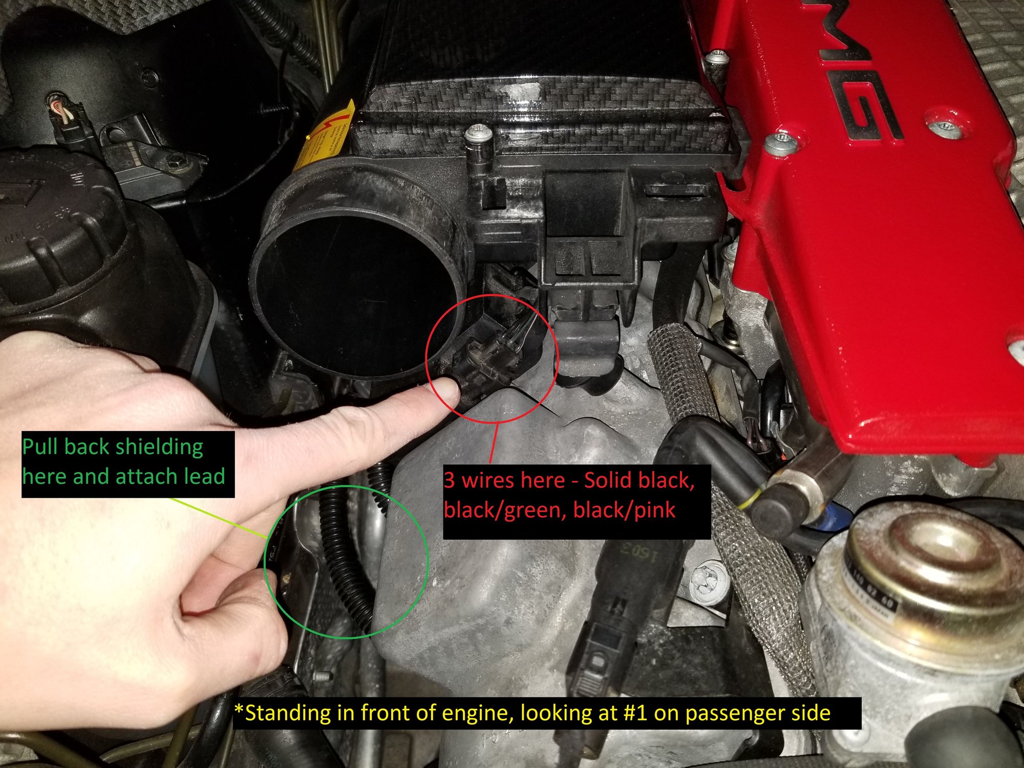

Jan 10, 2018 | 04:26 PM
So here's what I have when standing in front of the engine. The is looking at the passenger side first coil, which I believe is #1? Does the tach pickup get attached to the wire under the shielding circled in green, or one of the 3 wires circled in red that are on top of the coil pack? The 3 wires on top of the coil pack are solid black, black/geen, and black/pink.
Reply 0
Jan 10, 2018 | 05:03 PM
Green
