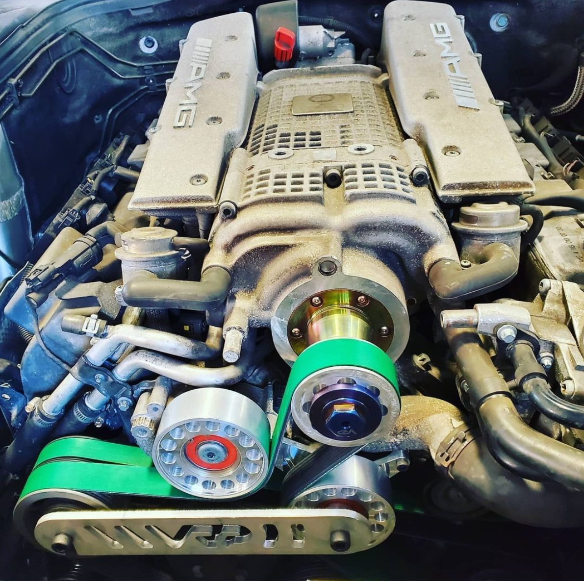

Superchargers with non-clutched pulleys are common in other cars from the factory. The challenge here is modifying a supercharger system that was designed, evaluated and stress-tested to be used with a clutch.
As evidenced by the operating chatter, this is not a modification without drawbacks...which are hard to justify given the great clutched options out there.

you guys are aware of what these superchargers sound like with a fixed pulley, correct? Sounds like marbles in a tin can, not very Mercedes-like at all
That is because of the idle speed for the blower is higher than engine idle, so it chatters a little. Notice how it goes away when driving? I have been clutchless for 3 years now. Everything is fine. Have 2 blowers that are clutchless, a 280 and a 580.
Originally Posted by eurochargedw210
Also last time I checked, all of the fastest 113k cars run clutched pulleys. Fixed pulleys are trash!
Let’s see VRP post some air intake temps, and some actual date on why to even use a fixed pulley.
Air intake temps will be high with ANY pulley change, regardless of clutchless or clutched. Specially if you have not taken the proper steps to attack hot air BEFORE changing pullies.
I run a 76mm clutchless with a 172 crank, I am hitting 14psi, and run an FI interchiller, I am seeing intake temps DROP during the end of my run.
40F at idle, 120F at the end of a pull on a 105F day.

We have literally sold hundreds of clutch delete pulleys.... its not "mercedes like" to run 10s either. as oneslow55 said, if you dont want the side effects dont mod the car. The chatter is a well known and documented occurrence. We have posted data MANY MANY times on the results of clutch delete pulleys. Its literally the exact same effect as putting a lightweight crank pulley on or a lighter flywheel on a manual car (if you went size for size). Intake temps are higher, but not at peak, and at idle they are negligibly different. if you have properly modified your cooling to match the size you select there is virtually no difference.
The pros massively outweigh the cons, And yeah, The same "fastest m113k cars" have been running clutched. However, the fact its a clutched pulley has nothing to do with their results, By that I mean those same cars with clutch delete pulleys would still be the fastest m113k cars in the world, only slightly faster.
Regardless of the chatter these clutch delete pulleys are rapidly becoming the most popular pulley type. have you heard the blowers rev with these on? The blower sound is insane.

To resurrect this topic... Any real-world data?
It's been another two years, and plenty of new people have had their SC clutches fail, and opted to swap in a clutch-less pulley...
Has testing been done which proves that further removing rotational mass from the equation provides sufficient justification for the "Clutch Deletion" VRP designed its more-recent pulleys around?
Has any real-world evidence been published to justify deleting the clutch magnet, and switching to the smaller form-factor of their 'backless' pulleys?
(I have a 77mm UPD clutchless pulley in place now, and don't imagine returning to a clutched pulley in future..)
Enquiring minds, and all that...
