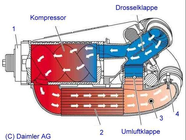

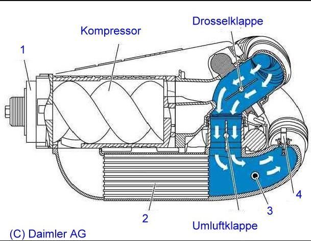

The blower vanes will be forced to spin from vacuum in the intake, even when the clutch is not "engaged" per say. Just the intake air flowing through them

It would probably eventually cause it to stall, if not at idle, definitely while under load due to lack of air.
