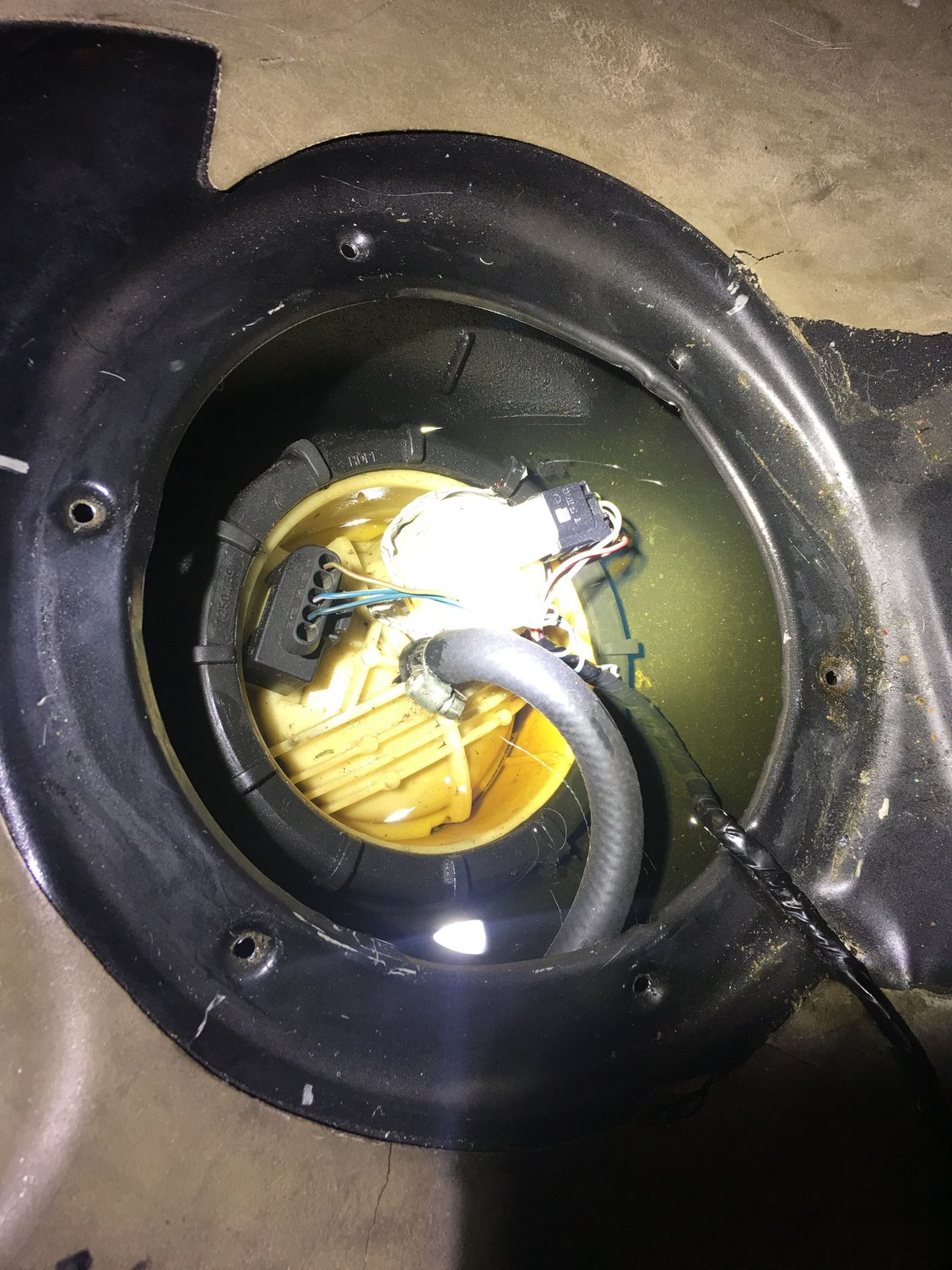

Well I opened up the rear seat and this is what I found! Fuel puddled under the left (driver side) inspection cover.. It looks like a part popped off? It took me 1 hour of soaking up fuel to get it to stop. Is this a recall? Should this happen?

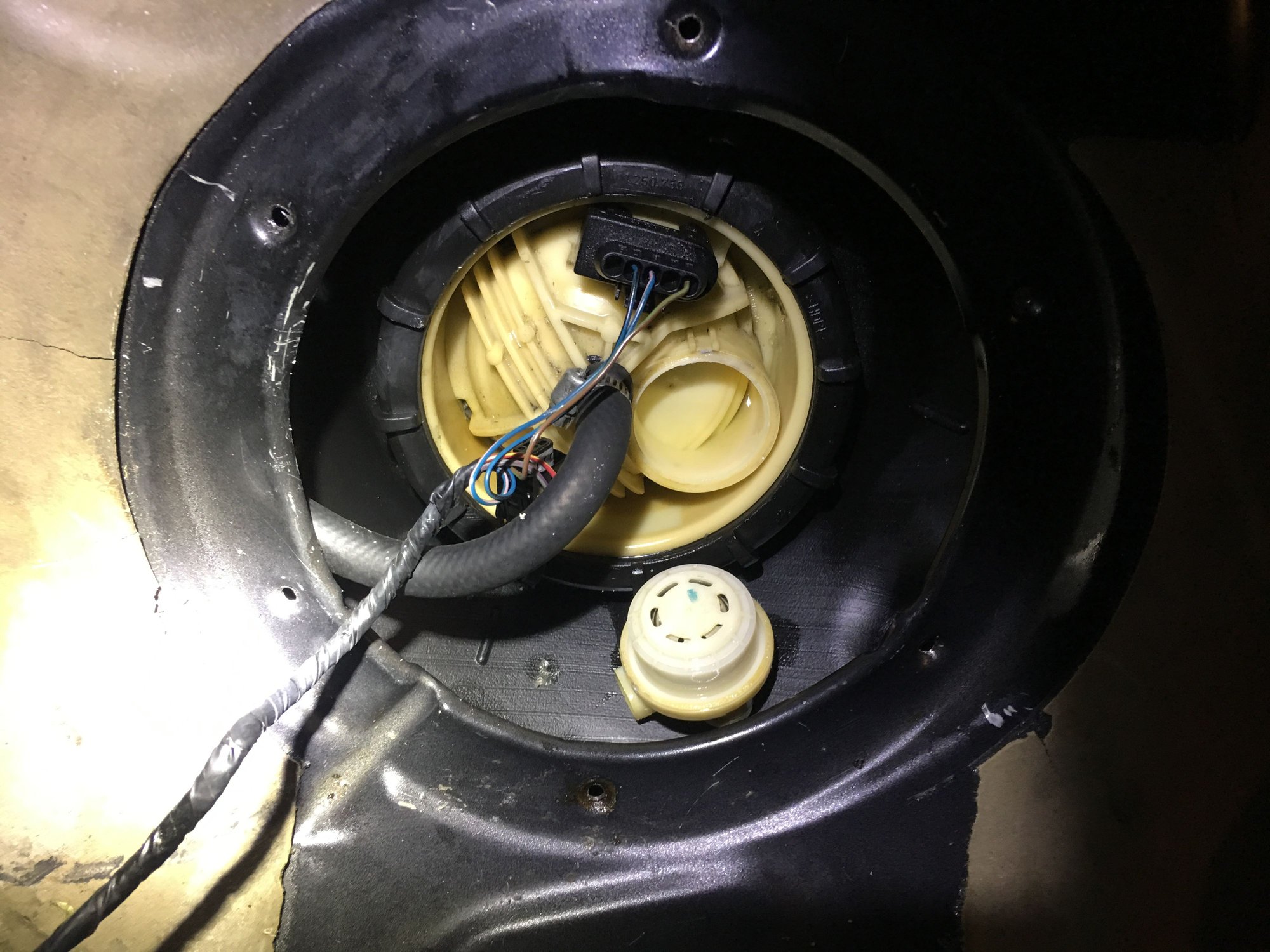

Another picture of the part that popped off.
Old Nov 21, 2018 | 09:46 PM

Yep go straight to MB since you are in the US. They will fix all of it for free.

Looks like the fuel tank pressure sensor. My car still smells of gas slightly since I had a similar experience.
