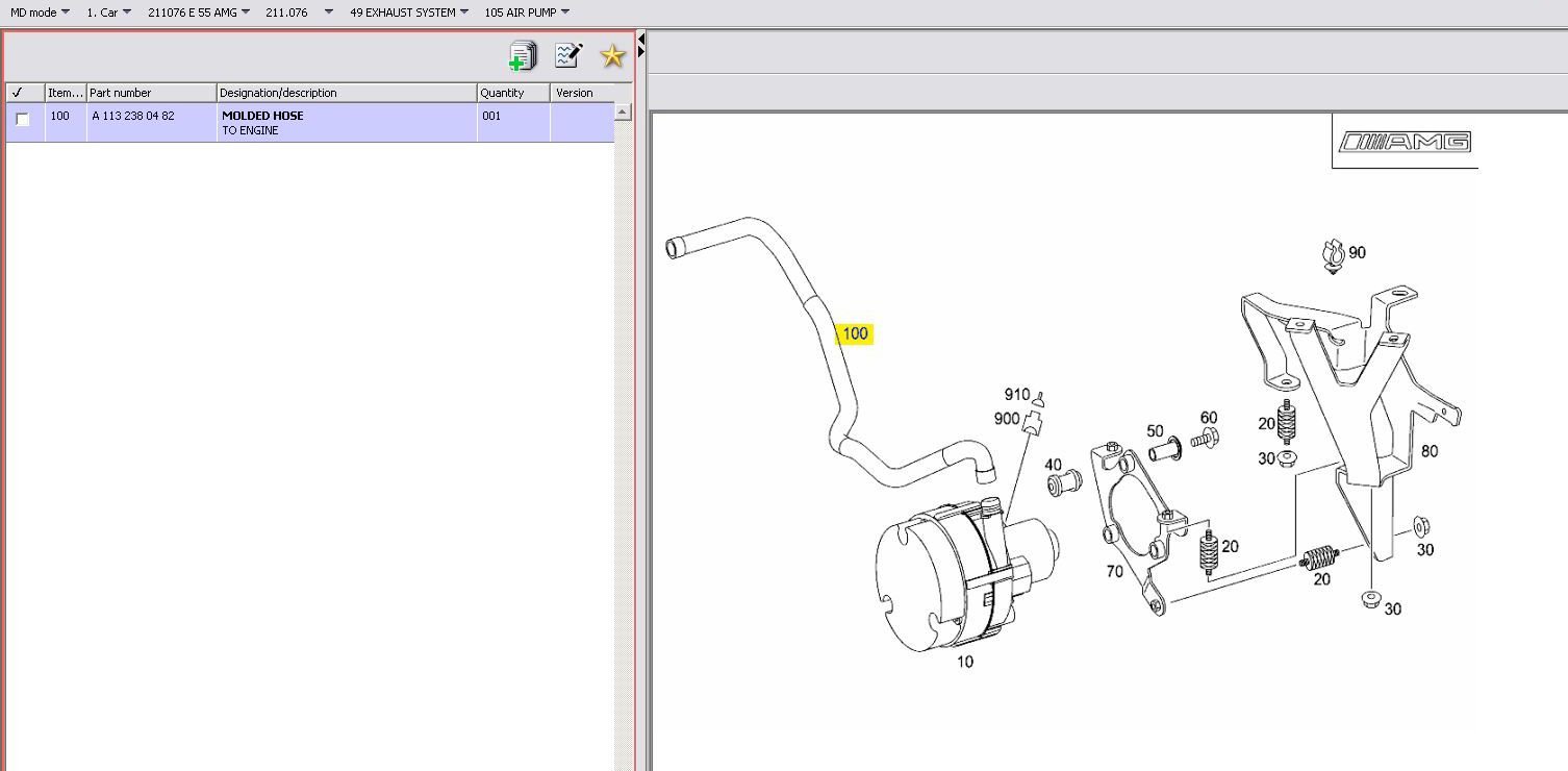

What Hose is this?
Can anyone out there help me determine what part number this hose is? I used an image I found online, but cannot read the number and mine got weed whacked to death by my S/C pulley. Trying to use online sites to order but cannot find it in any of the diagrams. Anyone know? Appreciate it.

I believe that is the secondary air injection hose, but I don't know the part number.

That is your air injection hose which goes to the air pump located behind the driver's side bumper.

The above are correct, that is the molded hose of the secondary air injection system. I'm surprised no one responded to this for you yet. Assuming you have a CLS55 from your signature, the part number is : 113 238 04 82. You'll never find it in EPC. It's buried so deep, Jimmy Hoffa would be impressed. Here's your reference:

Oh man, thanks. That's perfect. I appreciate everyone's help!
